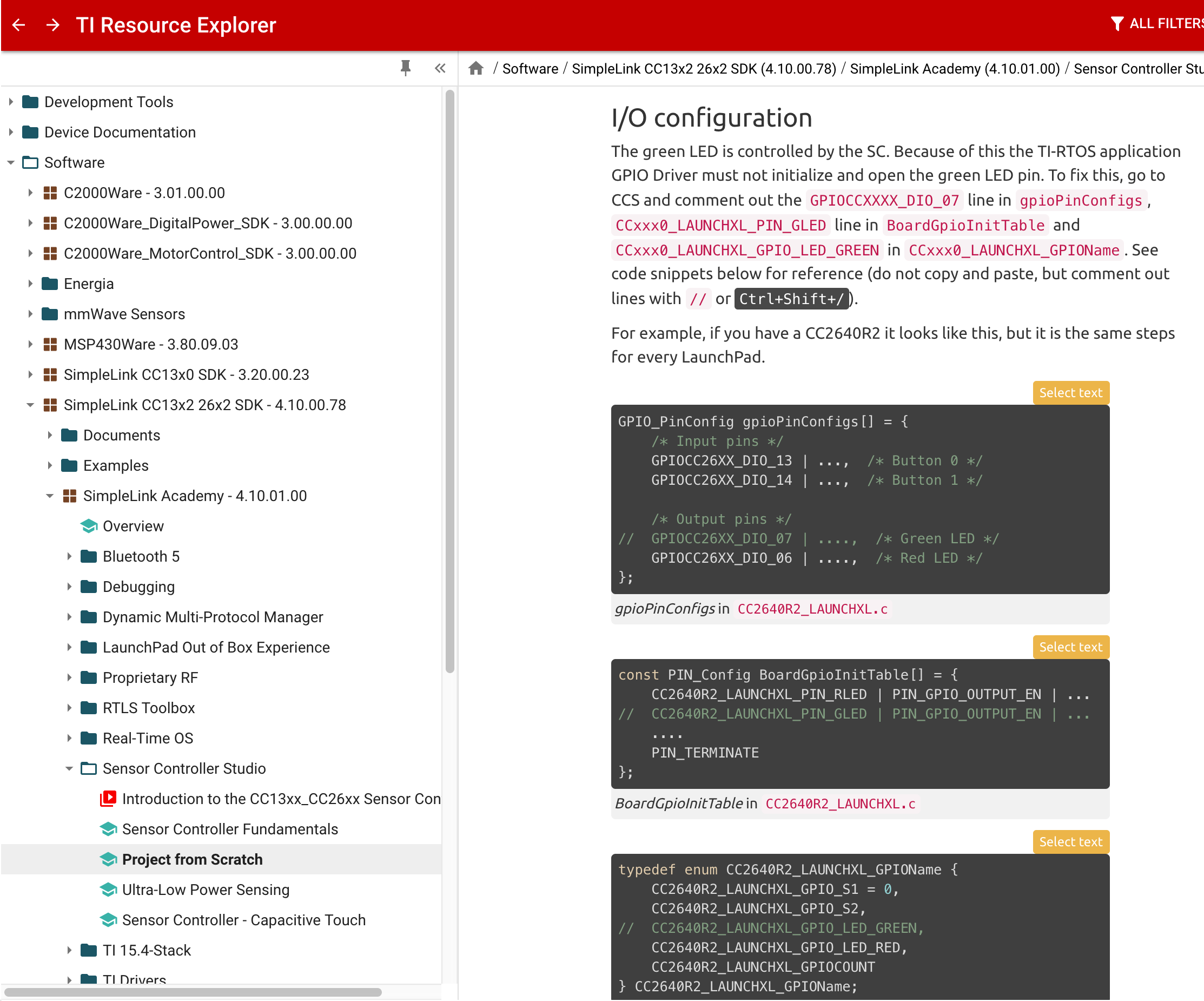

following SimpleLink Academy for Sensor Controller Studio, SDK 4.10, I think documentation needs to be updated to reflect use of SysConfig rather than board files:
Hi TER, thanks.
For now, I've resorted to commenting out these lines in the syscfg file:
/* ======== GPIO ======== */
var GPIO = scripting.addModule("/ti/drivers/GPIO");
//var gpio = GPIO.addInstance();
//gpio.$hardware = system.deviceData.board.components.LED0;
//gpio.$name = "CONFIG_GPIO_LED_0";
Removing GPIO completely from the UI results in Power policy errors.
For this SLA, wouldn't be easier to disable syscfg, see the SLA on syscfg on how.
