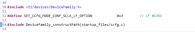

    When I select LF RCOSC the program starts and after about 1 second stops working. What could be the reason?

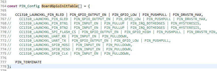

  • Yes, pinstandby, I changed the pin assignment to match my board:
    But on launchpad-1310 it works well!

    A typical failure on custom boards is that the 32 kHz doesn't start and the chip then never goes to sleep. But if you switch to LF RCOSC as you have done, nothing should prevent the chip from going into sleep.
    Could you share the full CCFG.c file you are using?
  • I took 1 second conditionally. Perhaps the program does not start at all. at least before switching the LED does not reach.

    #define SET_CCFG_MODE_CONF_SCLK_LF_OPTION            0x3        // LF RCOSC
    #include DeviceFamily_constructPath(startup_files/ccfg.c)

    If you replace
    with
    #define SET_CCFG_MODE_CONF_SCLK_LF_OPTION 0x2 // LF XOSC
     then everything is ok!

  • 1. LF XOSC works, but consumption is large (1.5mA)
    2. LF RCOSC DOES NOT WORK! Why?

  • It seems I figured out the problem.
    1. Probably there was some kind of CSS error: cleaned the project and recompiled pinStandby again - it worked. Until I cleaned it, it did not work.
    2. You were right - when working with RCOSC, the consumption in sleep mode is 3-4 μA. Probably we have problems with LF XOSC, we will deal
    3. Changing the DCDC settings will not affect the operation, all without changing them. How can this be controlled?
