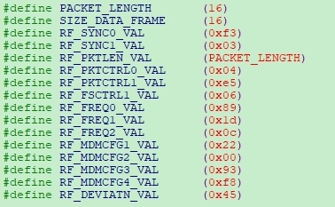

    When the customer uses FSK modulation signal reception, configure IOCFG1 = 0x0D.
    and the transmitter does not send data, but at this time the waveform of the P1.6 is as follow:
    Codes setting:
    He thinks TX does not send, there should not be so much data on the pin P1.6 .
    If he wants the waveform output on P1.6 only when the transmitter is sending data
    How to do ?
    Kevin
  • There is always noise on the air that you will pick up so what you see is normal.
