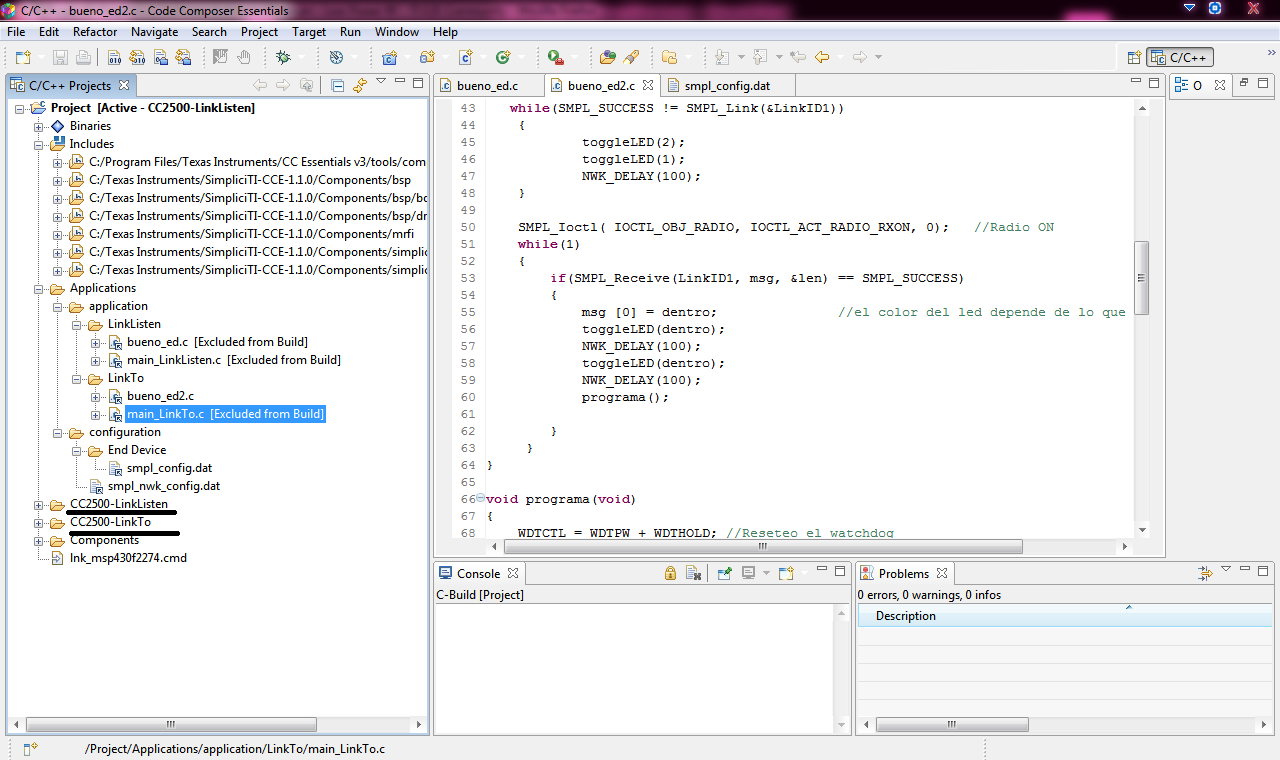

I've some problems with my program. I just triying link two end devices i dont know where is the problem because i dont have errors compiling and i have all the libraries.
ED1 Code : Linklisten

if(SMPL_SUCCESS == SMPL_LinkListen(&LinkID2)) // this part is working fine i think, Because im proving with LinkTo example SImple_Peer_to_Peer" and work fine with my proyect.

while (SMPL_SUCCESS != SMPL_Link(&LinkID1)) // in this part when im debuggin never pass form here whith the 2 ED working SMPL_Link() never is SMPL_SUCCESS

Im sorry for a lot of code, principally I have problems with "ED2 code : link" in the part with red, i dont know what is happen, maybe a variable, configuration.....If some can help me.
Additionaly I don't have any problem compiling the program, just is the communication that is unsuccesful
