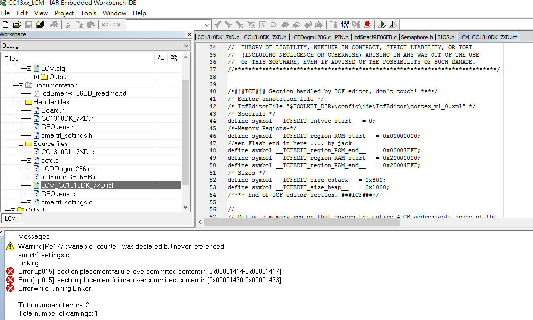

Hi Sir,
I use CC1310 launchpad and the other board with CC1310F32 for HW test. The FW code base on TI-RTOS example code and use IAR compiller .
The code is work well in CC1310 launchpad(F128) but I can't programming to CC1310F32.
I check the code size about ~31K in MAP file and show as below.
23 027 bytes of readonly code memory
8 537 bytes of readonly data memory
18 155 bytes of readwrite data memory
Modify setting for CC1310F32
The code size 23027 + 8537 = 31564 . It seems to be fine to programming to CC1310F32.
I modify the Target device to CC1310F32 in IAR Options setting and I change the Flash define setting in CC1310DK_7XD.icf.
Modify the link file for 32K flash size as below , the compile error occurred.

If i change the setting to 0x8BFF the compile will success, and the Hex file will over 0x7FFF. So I cannot programming into CC1310F32.
Did i miss something ? Why the compile file exceed MAP file over ~4K size ?
How to estimate real flash size of CC1310 if the Map file is not real?

  • Hi ,
    Provide the error massage as picture, and the Link file as attached file.
    After check the link file, it seems put CCFG to the end of Flash by command as below. How to modify the link file to use the last flash page.

  • Jack,
    Sorry for the delay I hve been travelling. I can not see anything wrong the linker, can you attach the map file so I can see what symbols it is struggling to place? Also can you remove the Exe, Obj and list dir as well as any of the generated src files. Then do a build clean.
    Tony.
