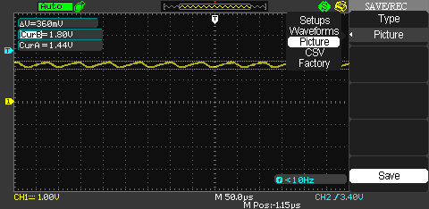

  4. On GPIOs of CC1310(Including TDI and TDO), I'm getting this waveform(Do you think this is the problem with Grounding? On LDK, GPIOs are grounded)

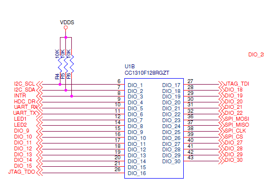

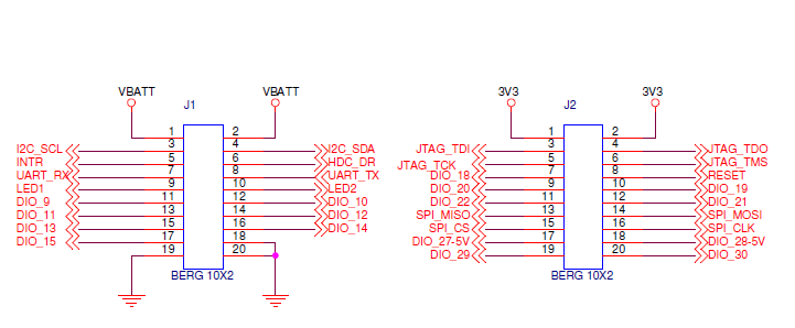

What do you think could be the problem? I'm posting schematics for you to verify. Do you notice anything unusual?

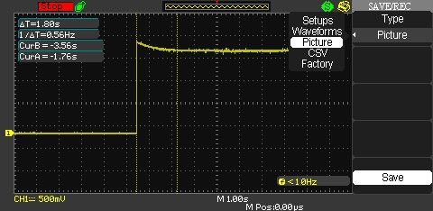

    I've observed one interesting thing while measuring Voltage on VDDR pin. The waveform of voltage resembles the "Voltage Discharging across Capacitor". (When I put the probe on 48 pin, the voltage decreases exponentially from 2.06V all the way to 1.88V in 1.8 seconds) PFA pictures of the same:
    • Voltage on VDDR pin on LDK(1.66V)
    What do you think is the problem here?
    Suresh
