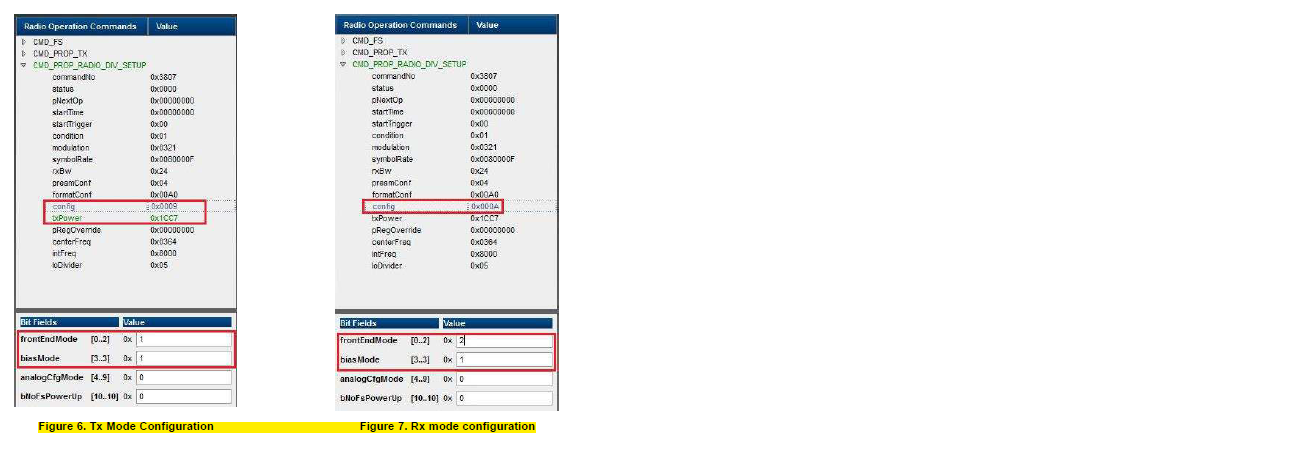

    In SmartRF the setup is as follow:
    2.4.1 DIO Configuration
    Based on the truth table of the SKY66115-11 shown in Table 1, SmartRF Studio should have the DIO
    configured as shown in Figure 5.
    Table 1. SKY66115-11 Truth Table
    DIO_1 (CTX) : LOW & DIO_30 (CSD) : HIGH ----> Rx
    DIO_1 (CTX) : HIGH & DIO_30 (CSD) : HIGH ----> Tx
    DIO_1 (CTX) : X & DIO_30 (CSD) : LOW ----> Sleep
    2.4.2 RF Front-End Configuration
    Figure 6 and Figure 7 show the configuration of Tx and Rx modes separately. This is configured in the
    CMD_PROP_RADIO_DIV_SE radio operation commands.
    For the Tx path configuration shown in Figure 6, RF_P is set to single-end option. The txpower
    parameters should also be configured based on Table 3.
    For the Rx path shown in Figure 7, RF_N is set to single-end option.

  • It looks like I didn't get all the relevant information about this when I asked around this summer:
    If you look in the application -> PALNA folder in the 15.4 examples you will find:
    void Board_Palna_initialize(uint32_t hgm)
    	if (hgm)
    	    CC13x0_LAUNCHXL_rfDisableCallback();
    		if (!palnaPinHandle)
    			/* Open PA/LNA PIN driver */
    			palnaPinHandle = PIN_open(&palnaPinState, palnaPinTable);
    			/* Set IO muxing for RFC GPOs */
    			PINCC26XX_setMux(palnaPinHandle, Board_CC1190_LNA, IOC_PORT_RFC_GPO0);
    			PINCC26XX_setMux(palnaPinHandle, Board_CC1190_PA, IOC_PORT_RFC_GPO1);
    		PIN_setOutputValue(palnaPinHandle, Board_CC1190_HGM, (hgm & 1));
    which should be possible to modify to cover your needs. The power table should also be updated to reflect that you are using a different frontend.
