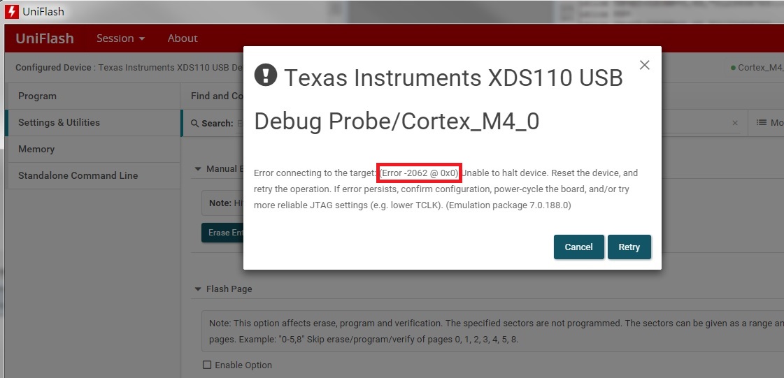

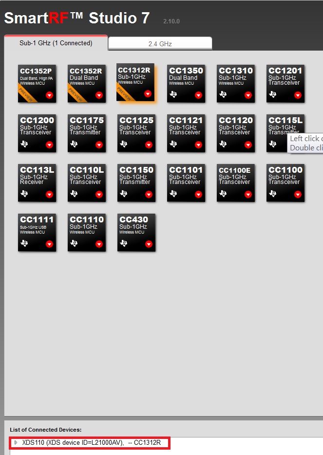

  • Hi TI,
    I found that smartrf can still get CC1312.
    It means JTAG connection still works.
    However uniflash can't read/write config and load firmware to CC1312.
    It always return Error -2062.
    I have the following question:
    1. What does error -2062 mean?
    2. Do you have any flash lock mechanism in the chip?
        Because smartrf can get but uniflash can't work, I suspect it's flash related problem.
    3. Because I can't do Forced Mass Erase, are there any other methods to save the chip back?
    Thanks!
    Vince

  • hi M-W,
    For locked CC1312, Uniflash cannot enter. Uniflash shows Error -2062. So customer cannot perform mass erase by Uniflash.
  • Hi Jerry,
    Could you elaborate on "Uniflash cannot enter", do you mean that the device can not be detected and connected to by pressing "start" on the device?
    Or can you connect to the device by pressing "Start" just that you can't read out the flash content?
  • Hi M-W,
    please see what Vince posted on Fri, Jul 20 2018 12:31 AM. Uniflash can detect CC1312. However, after click "Start", it will show Error -2062.
    I attach the snapshot again.
  • As I understands it, this error is encountered not when pressing "start" to connect to the target, but when trying to do an "Erase Entire Flash"?
  • Hi M-W,
    The error is not only encountered when do an "Erase Entire Flash".
    It's encountered when do all flash related operations, like loading firmware, erasing, reading settings ...etc.
    Vince
