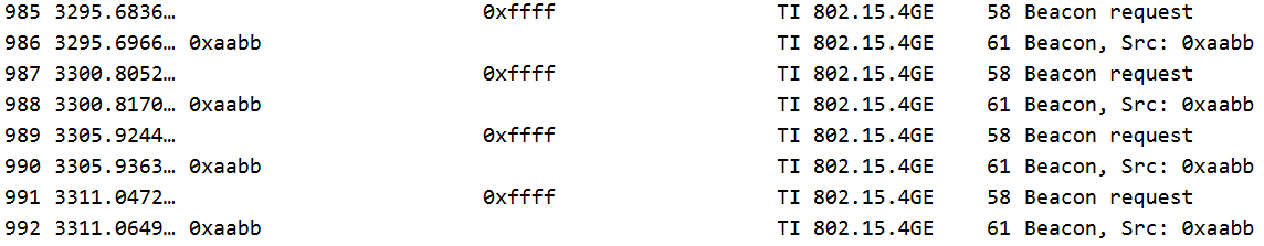

  3. Wireshark shows that every 5s a Beacon request is send to destination 0xffff immediately followed by "Beacon, Src:0xaabb" from 0xaabb but looks they are not pairing.
  4. When I remove the sensor, wireshark shows no further transmissions, so I guess the sensor was sending the beacons before, is that right?
  5. When I connect the sensor again, they pair and it works.

    But after that, the sensor tries to connect to the collector I just set to factory new, by sending beacons all the time. In wireshark it looks like this:
    The only way to get out of this "endless" loop, is to push the reset button on the sensor or unplug and re-plug the device.
    Any suggestions are welcome, I am very stuck atm...

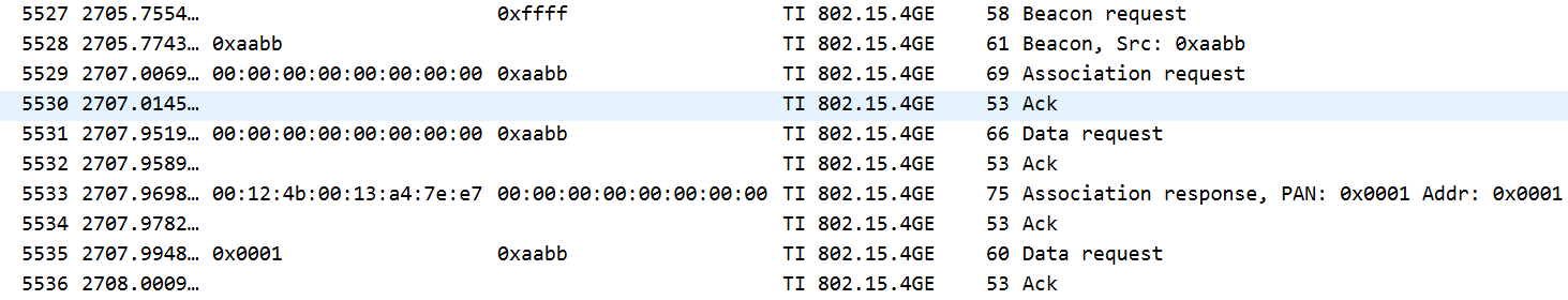

    5. Util_setEvent(&Jdllc_events, JDLLC_ASSOCIATE_REQ_EVT); <-- I had to add a associate request.
    Now, it is not stucking in endlessly sending beacons, Wireshark shows this:

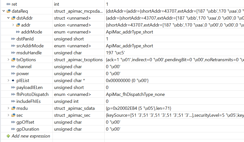

    After that, the sensor should start sending messages and it tries, but in the Sensor_sendMsg() function, I can see, that ret is set to true. So the message should be transmitted. Is there a reason, why the extended sensor address is 00:00:00:00:00:00:00:00??
        /* Send the message */
        if(ApiMac_mcpsDataReq(&dataReq) == ApiMac_status_success)
            ret = true;
    The pointer dataReq is filled like this. I compared it to when transmission works and the content looks the same. I dont know why the channel is "0" though it is set to "2" but it looks the same when it works. Can you see anything suspicious?
    Any idea, why I cant see the message in wireshark and collector is not receiving the message?
    It looks to me, that after deleting NV and PAN info and all the stuff, I have to set some plattform specific funtions again. But I dont know which...
