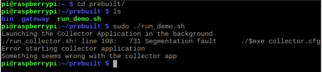

    I copied prebuilt directory to pi zero w and run script "run_demo.sh" which shows me this error
  • It seems the prebuilt hex is for armv7 and is not compatible to armv6 which is used by CPU core of Raspberry Pi Zero. I suppose you have to rebuild the binary using cross compiler of Raspberry Pi Zero by yourself to make this work.

  • Hello Chen,
    I followed the steps that you suggested and I have successfully compiled  "./build_all.sh bbb"  but still "run_demo.sh" is not working on Raspberry Pi Zero. I am attaching build log and the Screenshot of the error below.

  • After you build binary, do you copy it to Raspberry Pi Zero?
  • Yes, I copied "bbb_prebuilt.tar.gz" to the Pi Zero and extracted it.
  • Are you sure "bbb_prebuilt.tar.gz" is built by you?
  • If I follow TI 15.4-Stack Linux Gateway User Guide then it is supposed to be the file built by "build_all.sh" and that is why I copied it.

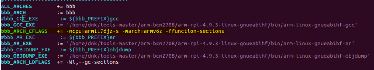

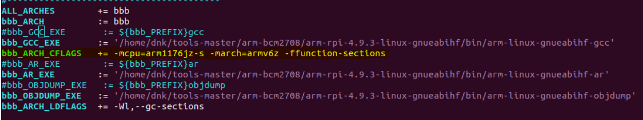

  • What bbb_ARCH_CFLAGS do you use in front_matter.mak?
  • Here is the snap of  front_matter.mak.

  • I remenber it will build binary bbb_collector under example/collector folder and I suppose it won't pack a new bbb_prebuilt.tag.gz. I suggest you to copy the whole ti 15.4 stack source folder into your raspberry pi zero and run bbb_collector under example/collector folder to see if it works.
  • When you set bbb_* variables, do not enclose them in quotes ('). Just write path as normal.
  • Thanks Chen,
    As you suggested I copied whole ti 154 stack source , run the collector app , and it's working now.

  • Thanks for your reply Edvard,
    I made the changes you suggested ,,but it seems it doesn't makes any difference it is now working in both the condition. anyway , the issue has been solved now. :)
