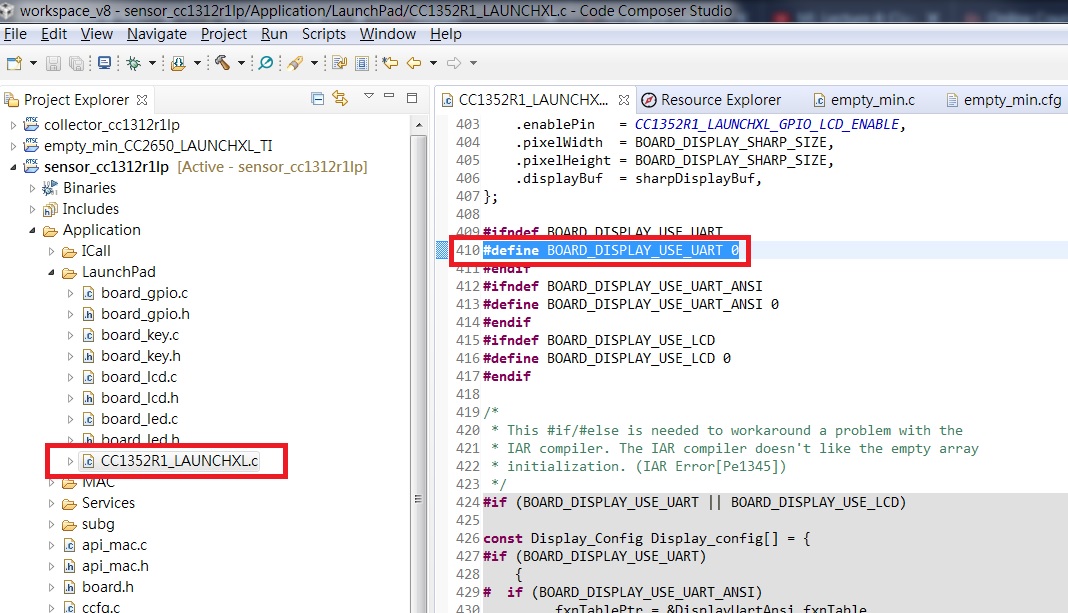

I'm having issue regarding cc1312 power consumption. I have been through all of the available threads on this topic and tried it too. sadly any of these available solutions didn't worked for me so I created a new thread.
I am using default ti 15.4 stack sensor board code
I have removed POWER_MEAS predefined macro.
Polling interval is 6000
before connecting to collector it shows  ~6.49 mA and once it is connected to collector it shows ~50 uA (which is supposed to be around ~10uA),
Can anyone suggest me what I'm doing wrong? Or how should I measure it accurately?
