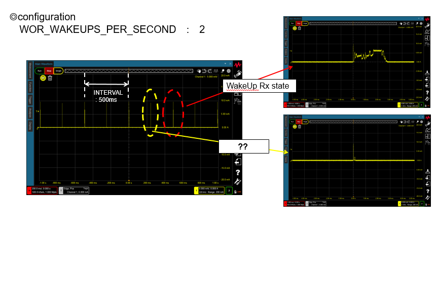

  • Thank you for the information.
    I used CC1310 LaunchPad to check the operation of sniff mode. I used sample code "RF Wake-on-Radio RX".
    When receiving,The Consumption current during reception is 5.5 mA.
    When sleeping(standby), It was about 1 mA. On specifications, when sleeping,we expect 1uA or less.

  • Thank you for answering.
    I could measure with CC1310-LaunchPad. The cause that can not measured was Power supply noise.
    the measurement result with CC1310-LaunchPad is following.
    We think that it become Rx state every 500ms.(red dotted circle). and There is a rise that is not Rx state(Yellow dotted circle).
    what is the rise in Yellow dotted circle.
