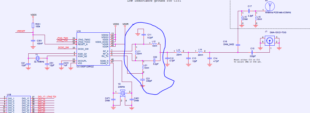

I am currently working with LAUNCHXL_CC1310 which is operating at 868 MHz band. I need to migrate it to 400 MHz band. Is there any reference design available for the same ?
Thank you in advance for any help you provide.

1) Yes. You may need to scale the components a bit. I would first test @400 MHz with the 433 MHz BOM. Then you can scale the components with a 400/433 factor and see if you get any better result.
3) http://www.ti.com/lit/an/swra528/swra528.pdf could be used as a starting point.
