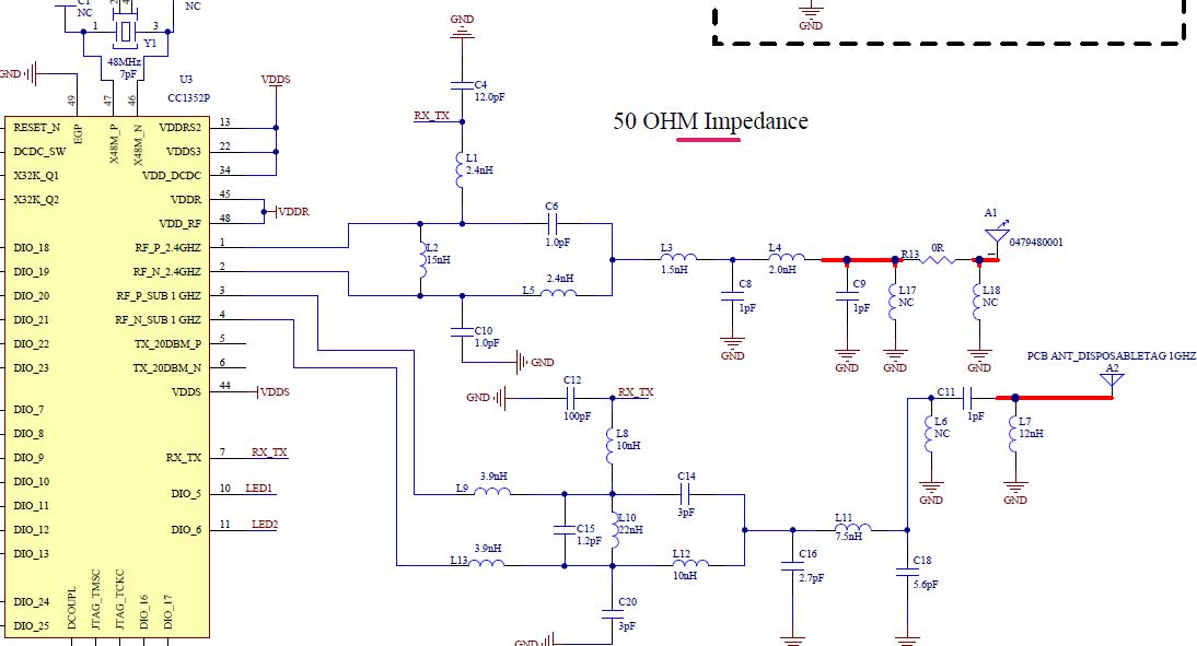

I designed a custom board using the CC1352P but was unable to use the SmartRF tool to verify the Radio TX/RX functionality for both 2.4GHz and sub 1 GHz. However I was unable to get SmartRF Studio working for the same.
The schematics is shown below:- [used the same components as used in the CC1352P1 launchpad schematics]

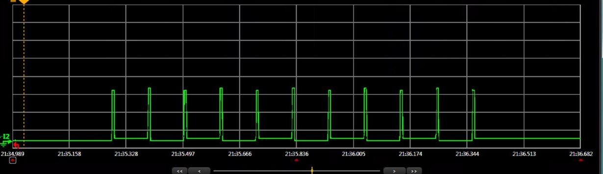

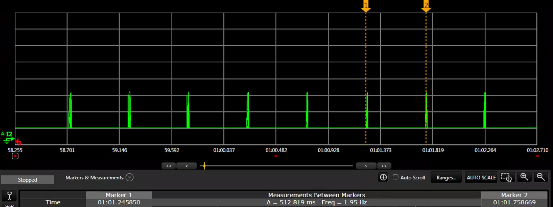

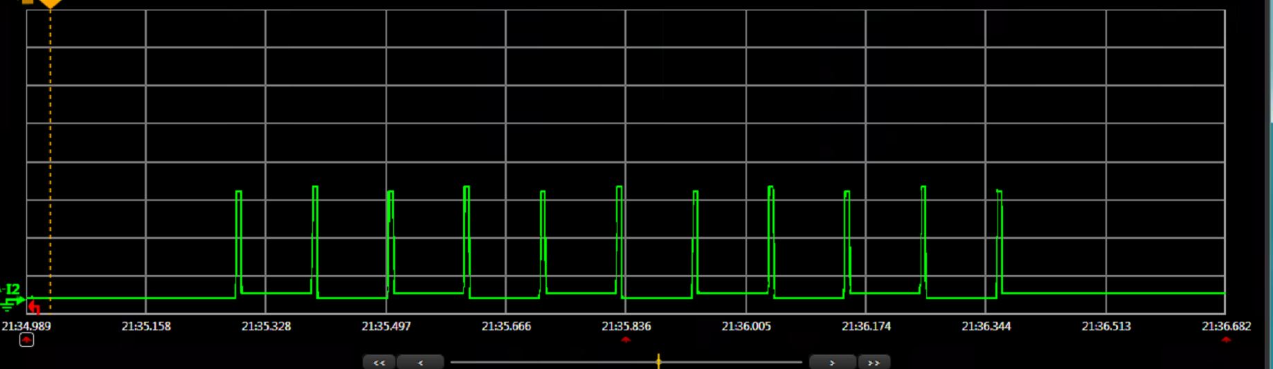

1) For BLE (Simple peripheral) :-
- Set the advertisement interval to 500ms and single channel transmission, I could observe the TX on BLE Sniffer(CC2540) and also on a current-meter.

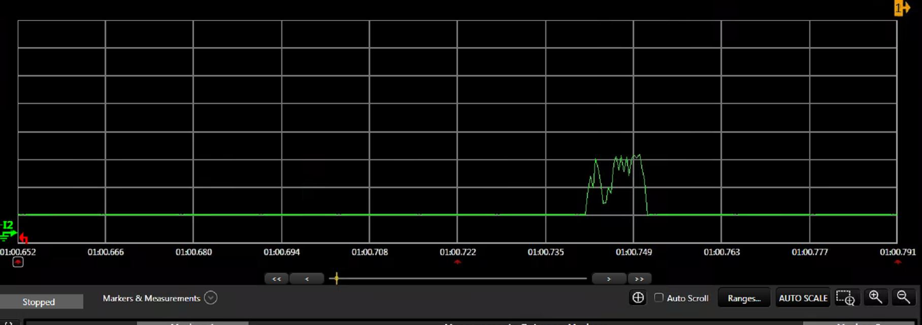

2) SUB 1GHZ (rfEasyLinkTX )
I could only view it on the current-meter.

    In order to verify if the board is functional I made use of two examples from the SDK CC13x2_26x2_sdk_3_20_00_68, for BLE and Sub 1GHz.
    I attached the current-meter screenshots so that you can help me confirm if its a fault in the schematics or is there anything else to be done to get this board working.

  • Hi Sanjay,
    Since the board otherwise seems functional, my guess would be that you have a frequency offset on the RF carrier due to a poorly tuned 48 MHz crystal. You can verify this by measuring the RF output on a Spectrum Analyzer.
    Refer to the crystal tuning chapter of for www.ti.com/lit/pdf/swra640 details.
