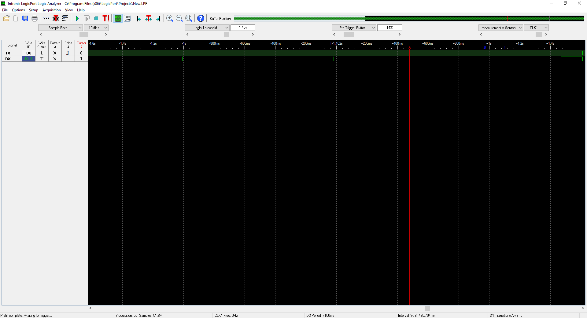

  • I recommend that you monitor the LNA signal on the receiverand (this is already routed out on a pin in the rfWakeOnRadioRx example) at the same time as you look at the PA signal from the transmitter
    This way you can make sure that your timing is OK and that your receiver is entering RX state while the transmitter is sending data.

  • It is not correct that TX transmits every 500 ms. TX transmits 1 packet everytime the button is pushed. The preamble length of the transmitted packet is 500 ms and is set by:
    RF_cmdPropTxAdv.preTime = WOR_PREAMBLE_TIME_RAT_TICKS(WOR_WAKEUPS_PER_SECOND);
    WOR_WAKEUPS_PER_SECOND 2 is also used by the RX code and means that the RX is configured to wake up 2 times a second (every 500 ms). Since the RX wakes up at this rate, the preamble of the transmitted packet must be equally long to make sure that that one of the RX wake-ups happens within the preamble.
    The plot above shows the WOR example running with the default 50 kbps settings and WOR_WAKEUPS_PER_SECOND 2.
    The RX signal is measured on Board_PIN_LED0:
    /* Route out LNA active pin to LED1 */
    PINCC26XX_setMux(ledPinHandle, Board_PIN_LED0, PINCC26XX_MUX_RFC_GPO0);
    To monitor the TX on the transmitter board, you can add
    /* Route out PA active pin to LED1 */
    PINCC26XX_setMux(ledPinHandle, Board_PIN_LED0, PINCC26XX_MUX_RFC_GPO1);
    Remember to add:
    #include <ti/drivers/pin/PINCC26XX.h>
    I tried settings WOR_WAKEUPS_PER_SECOND 0.2f to achieve 1 wakeup every 5 s, but I did not get this to work.
    It might be that there are some calculations that goes wrong when not using an interger, but I have not time to look into this right now. Setting it to 1 works, and the preamble is then 1 s long, and the receiver wake up once every s.

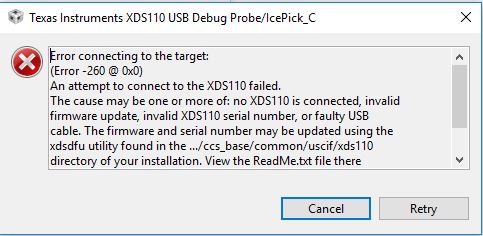

  • In TX related code, are you sure it goes to the line "RF_runCmd(rfHandle, (RF_Op*)&RF_cmdPropTxAdv, RF_PriorityNormal, NULL, 0);"? Can you set a breakpoint to confirm it?
  • I can't debug, I have this kind of error:
