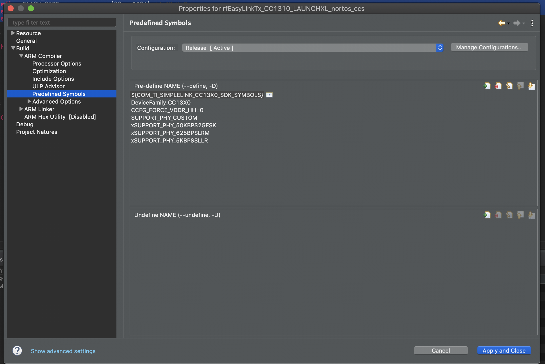

  • Ralph,
    I'm able to recreate what you are seeing. Let me contact our compiler experts to see if they have any suggestions.

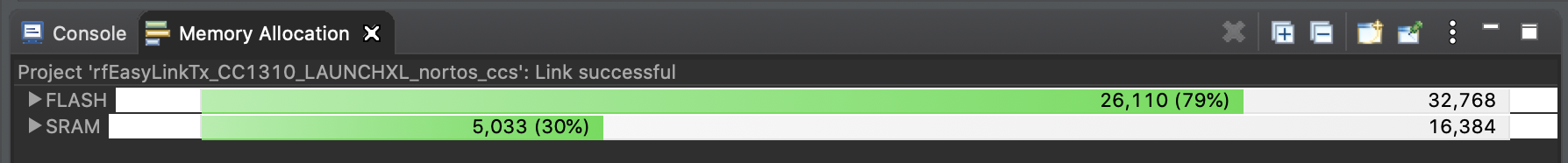

    In the meantime, if you go to View > Memory Allocation, you can view a graphical representation of Flash and SRAM usage. In the case of this example, it looks like the SmartRF Settings (which are generated once to allow for interoperability between devices) are taking up a lot of Flash. I'll continue to investigate this.
    Daniel
  • Nice,
    at least I am not doing wrong. Compiler is 18.12.6 but I see same in 20.x.x
    nice weekend
    Ralph
  • Ralph,
    Please try removing the PHYs you aren't using from Predefined Symbols in your project settings. Doing this will make the example fit in the CC1310F32 memory. (An easy way to do this is to add an "x" in front of the pre-define.) In the screenshot below I removed all PHYs except for SUPPORT_PHY_CUSTOM.
    Daniel
