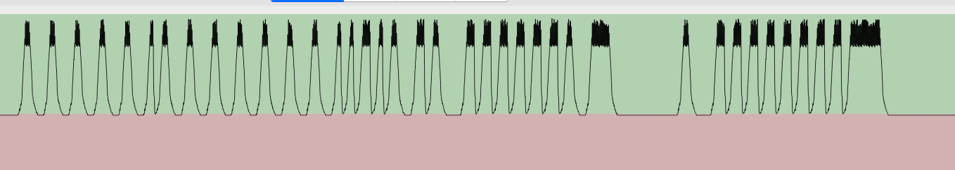

  • I can see, that the CC1310 is transmitting one pulse (width ~84us) with these settings:
    If I only change the baudrate to 4.8kbaud then the signal looks like this:
    If I change HW_REG_OVERRIDE(0x6098,0x6E00) to HW_REG_OVERRIDE(0x6098,0x0E00) the output looks like this:

  • Hi Thomas,
    I asked the radio team to look closer at it and it seems that the CC1310 firmware does not allow for this today due to the PA ramping scheme used. While the PHY could potentially be updated to support higher data rates, it is currently no plan to do so I'm afraid.
  • Oh these are bad news...
    Is there no workaround? I don't need PA ramping with different levels
    If I play a little with the values of register 0x6098 and 0x52B8 something happens.
    For example the output signal looks like this:
    But the timing is not correct. The smallest pulse is 32us long (should be 8us)
  • Hi Thomas,
    There is no simple workaround that I could propose for you to test out "as is" from what is in the SDK. What I got from the modem team is that this is likely a patch related fix to get working at these speeds but the wait times now a day is long so the chance to get a new patch out in short term is not likely (in the end, it boils down to the business case for it).
    I have however made them aware of it and will do my best to get it on the CBL.
