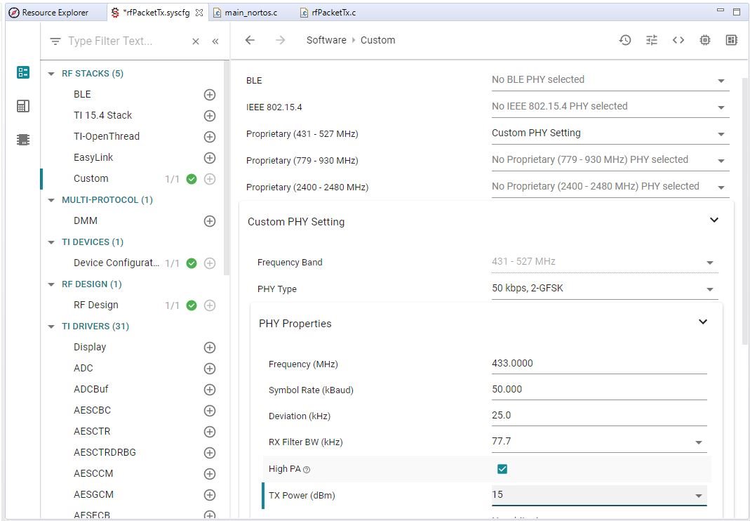

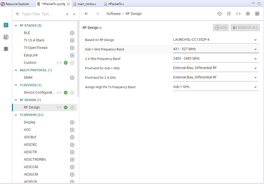

I have a CC1352P custom board where the PA path is connected to an external antenna, and Sub-GHz path is connected to another antenna. I need to transmit at 436MHz (amaterur band) with 20dBm power. How can I enable PA for this frequency? I tried enabling PA for 431-527 MHz range with the example program (rfPacketTx), but no luck. However, it works with PA disabled.

    When you say you tried to enable the PA with rfPacketTx, what did you do?

  • The above two settings. I also got a new PA table in radio_config.h generated automatcally by sysconfig but I am not sure how to use this.

    Regarding enabling the PA on 433 MHz, this looks correct. What happens when you do this? What is the output power?

    I did two tests -
    1) rfPacketTx project, transmit at 13dBm -> Works fine, I get the RF output on 14dBm TX pins.
    2) Same project, just the settings are changed to enable PA as shown in the pictures above. There is no RF output.
