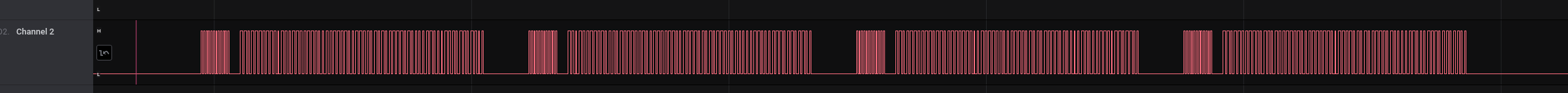

Next, I'm trying to send data, changing the state of pin is connected to GD0

sendRawData(0x2020, 0x456AAA32, 420)
My RTL-SDR doesnt show any activities from cc1101, where am I not right?

    Unfortunately, I can't test cont. TX in SmartRF studio, cause I use my own custom board, but I can test GD0 with logic analyzer (on my board as initialized as OUTPUT)
    UPD
    I checked with my logic analyzer the GD0 Pin, the pulse is correct
  • Hi
    Your settings is according to SmartRF STudio except the FOCCFG register (Studio set this to 0x14 and you use 0x16, why?)
    I did not understand what we see on the plot you sent. Is this GDO0 on your transmitter or your receiver?
