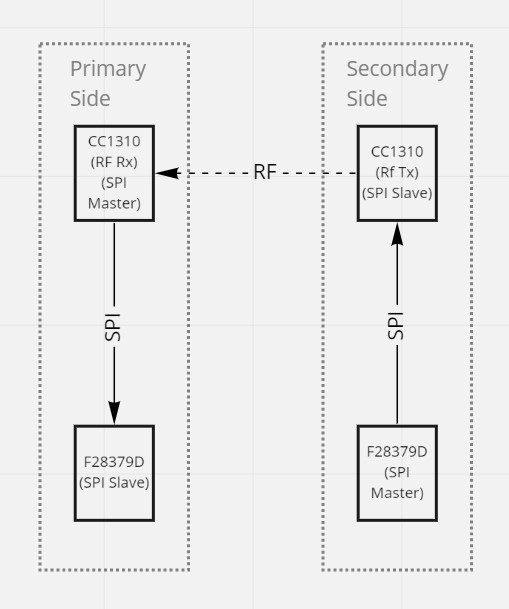

I'm trying to get a TMS320F28379D board to communicate over SPI to a CC1310 launchpad, I then want the CC1310 to broadcast the values that are received over RF, at the moment I can get the CC1310 to receive and interpret the F28379D's values over SPI, but the example code I am using is struggling to receive these values over SPI and transmit over RF.
Aosker
    To transmit the information over the air I would recommend you take one of the RF driver examples as a starting point. E.g. RF Packet Tx:
  • Sorry I think I missed a bit of explanation here, also apolpogies for the late reply!
    On the CC1310 Launchpad board, I currently am using the rfpacketTx example to transmit packets over RF and the SPISlave example to receive data over SPI from my TMS320F28379D board.
    What I need to happen is for the CC1310 to transmit over RF, the values that are received over SPI.
    I've tried meshing both the examples together and running threads, but these don't seem to work very well.

  • Oh this looks great, but I have a bunch more questions now if you don't mind.
    A few of the other examples all seem to copy the data to be sent, in very........................interesting ways.
    How might I do it here, going from TMS320F2379D data received over SPI, to CC1310 data to be emitted over RF?

    Would you guys happen to have any ideas on how to run the rfPacketTx code past the SPITransfer point?
    Thanks so much!

  • Hi Siri,
    Thanks so much for this, although it seems to work briefly, and then the SPI transaction seems to be cancelled.
    In the end I'd like the entire operation to be continuous regardless of what set of values are sent over SPI to the CC1310 board.
    On another note, while I was using your code, you gave me an idea actually, to fuse bits of your SPISlave function code into the rfPacketTx.c code.
    Below is the resultant that works very briefly. It seems to stop

  • I assume that you are communicating with another SPI slave that is not a CC1310. Is that correct?
    it is unfortunately not possible for me to know what the problem is on the slave side, when I do not have the master side to test with.
    If we shall be able to help you any further you need to make a dummy master running on a second LP that do the same thing as the real SPI  master.
    If we have both the master and the slave code up and running on two LP we can test the code, and maybe figure out what is going on, but this is hard to figure out when we do not have any way to re-create the problems you are seeing.
    BR
    Siri
  • Hi Siri,
    Oh I'm sorry for not providing you with the context!
    So what I'm doing is I'm using a TMS320F28379D Launchpad to communicate ADC measured values, to a CC1310 over SPI.
    I then want the CC1310 to transmit these ADC measured values over RF to another CC1310, who will relay these ADC values onwards to another TMS320F28379D. Pictured below is what I'm trying to achieve.
    Each square is a different microcontroller which performs a different set of communication instructions.
    The F28379D on the Secondary side currently measures values using some ADCs and communicates these values over SPI continuously.
    The CC1310 on the Secondary side is almost able to Receive these values and send them straight off over RF simultaneously, however the entire program seems to hang after one round.

  • Hi Siri,
    Please don't leave me! I feel like I am so close to the solution now that I have found where the code seems to be kicking up a fuss!
    I stuck a whole bunch of tracking variables and found that the program seem to hang at this line without progressing further:
    RF_postCmd(rfHandle, (RF_Op*) &RF_cmdFs, RF_PriorityNormal, NULL, 0);
    What it seems is happening is that SPI buffer is being read with no problems. This particular RF command seems to be the sticking point in this program.
    I've tried looking through what happens the SPI transaction variable and the Transaction seems to be completed, as is what it indicates when the rest of the programs is hung.
    It also seems as though whatever other board I try, there doesn't seem to be a change in result; the code still stops functioning at the same spot.

  • Oh my god you are amazing!
    The code now moves on past the hang point and it seems to be continuously transmitting hooraaaay!
    Just to see if the code was actually transmitting something, I ran the packet rx example in Smart RF Studio with another CC1310 and whaddaya know! The right data really is being transmitted over RF! Yaaaay!
    Would I be doing a similar thing to what we just did, to get the vice versa set of functions going? (ie. where I need to use another cc1310 to receive this data from RF and send it over SPI)
    Thanks sooo much for your help!
  • Hi
    Glad to hear that you are making progress :-)
    To make the receiver, you can use the rfPacketRX example as a starting point. Please note that this example sets the repeat mode to 1, meaning that the device will never exit RX.
    You should replace the RF_runCmd with RF_postCmd for the RX command, and then pend on a semaphore (posted in the RX callback):
