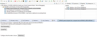

    If I insert SD card and then flash the code into device, it works good. But it stops working after same card is removed and plugged in  - SDFatFS_open() always returns non-null, but f_open will return FR_DISK_ERR. I think this issue is described in this thread https://e2e.ti.com/support/wireless-connectivity/wi-fi-group/wifi/f/wi-fi-forum/973275/cc3220moda-when-sd_initialize-fails-it-goes-to-unrecoverable-state-and-always-returns-error
    Also periodically I observed code stuck inside SDFatFS_open() function when there is no card in slot (which might be issue described in this thread), but I cannot debug issue deeper because this is CCS what shows me when I pause debugging:
    I also have hard time digging deeper into issue because after I step into SDFatFS_open() function I cannot see the code:
    Will continue my experiments
    BR,

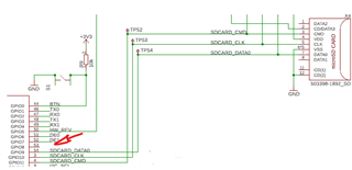

  • Hi Sarah. Thanks for your advice - it worked just fine. I am able to reproduce issue discussed in this topic with non-patched SDK.
    The code and overall setup is same as described in my previous message. If SD card is unplugged and code is running, then while() loop executes a couple of iterations and then hangs in this place. Maybe you can try similar setup and similar code on your side using launchpad?
    BTW we have hardware somewhat different to launchpad, SD host is connected to other pins, like this:

  • Hi Vadym,
    It looks like the driver is not equipped the handle the issue you are seeing when the SD card is not inserted and there is no hardware check. Ideally, there would be a timeout option in the driver to avoid this situation. I can make a request, but I don't know what that timeline would be.
    In the interim, I suggest adding a timestamp check to that while loop to exit and recover gracefully, or you can rely on the watchdog to reset the device.
