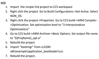

I am using CC3200 LAUNCHXL board. I am trying to do OTA example given in the SDK. I am using
SDK - 1.5.0
CCS - 10.4.0
Service pack - CC3x00ServicePack-1.0.1.15-2.14.0.0
Uniflash - uniflash_cc3xxx_setup_3.2.0.00123
I am following the example given in the CC3200_OTA_Update_Application_Note given in the docs folder of the SDK.
I did the following step for Application_Bootloader.bin which is in pg 11.
After that I followed the steps given in pg 23 for dropbox
After that I am following the steps from pg 24 and 25.
I added the application_bootloader.bin in /sys/mcuimg.bin and ota_update_nonos.bin in /sys/mcuimg2.bin.
After that if I format the SFLASH with 1MB and then program the "servicepack_1.0.1.15-2.14.0.0.bin" in service pack programming. Then I click on program and the files get programmed to the board. Then if I remove the SOP 2 jumper and reset the board then nothing is printing in the terminal. The port is getting detected and I am able to open the port in the terminal but I am not getting any prints.
