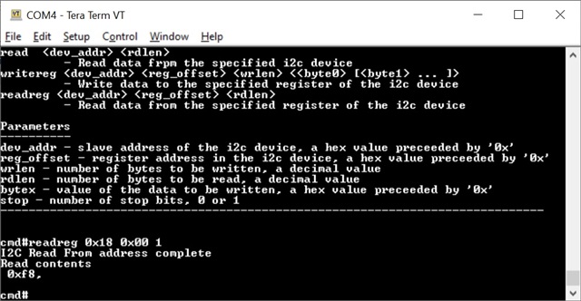

It seems like I can successfully read the accelerometer on the CC3200 Lauchpad via I2C. However, it is returning the ID 0xF8. The schematics show the part number BMA222 which should have ID 0x03. BMA222 isn't manufactured anymore, so I thought maybe TI replaced the part with a more recent Bosch accelerometer. Unfortunately, ID 0xF8 doesn't seem to match any of the current Bosch accelerometers that I could find datasheets for.
Can anyone tell me what accelerometer is being used on the CC3200 lauchpad, or what else might be going wrong here?
