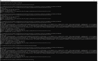

I am using the boostxl-cc3120mod booster pack on a MSP430FR5994 MCU.  I am trying to use the wifi module to communicate on the internet through the MSP430.  I have successfully provisioned it and can use the mobile app to make the wifi module ping another computer on my network. So, it has been provisioned successfully.   I am not using any type of RTOS.  When I put sl_Start() function in my code a compile give me error no matter what compiler I use.  For IAR the error is  "Undefined external 'sl_Start' referred in wifi"  The file is called wifi.c.  In the preprocessor section where I have to add the include directories I put the sdk wifi plugin 4.20.00.10 but that gave me more errors so I tried cc32xx sdk 5.30.00.08.  I have also tried to use the xdctool and I attached a picture of the results.  Here is my code for wifi.c

    btw ... at your image above you trying to compile for Cortex-M4F with RTOS support. MSP430 is not a Cortex-M MCU.
