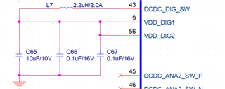

1. CC3100 serial port communication is normal, but wireless connection is unavailable. Measure DCDC_ ANA、DCDC_ PA、DCDC_ The DIG voltage is normal. How can I troubleshoot it? Is there a register that can be set?
2. PIN41 DCDC of CC3100_ PA has no voltage, does it indicate that CC3100 has been damaged?

Fault board 1
Power supply: VDD_ ANA output 1.9V, DCDC_ PA_ SW power output 0.2V, VDD_ DIG power output 1.2V
Oscilloscope fails to measure CS waveform of FLASH Failed to print WiFi connection of SCM software serial port
Change the FLASH of the faulty board 1 to the normal board Power supply: VDD_ ANA output 1.9V, DCDC_ PA_ SW power output 0.4V, VDD_ DIG power output 0.9V Oscilloscope can measure CS waveform of FLASH Failed to print WiFi connection of SCM software serial port It indicates that the flash of fault board 1 is faulty
Change CC3100 of fault board 1 to normal board Power supply: VDD_ ANA output 1.9V, DCDC_ PA_ SW power output 0.4V, VDD_ DIG power output 0.9V Oscilloscope fails to measure CS waveform of FLASH Failed to print WiFi connection of SCM software serial port
It indicates that the CC3100 of fault board 1 is faulty
Change the CC3100 and Flash of the normal board to the faulty board 1 Power supply: VDD_ ANA output 1.9V, DCDC_ PA_ SW power output 0.2V, VDD_ DIG power output 1.2V Oscilloscope can measure CS waveform of FLASH Can connect to WiFi and print signal strength It indicates that other components of fault board 1 are normal

    What do you mean by PA_ SW power output? Are you referring to Pin 42?
    For VDD_ DIG power output, you are referring to pins 9 & 56?
    //L6 Between P40 and P41
    //L7 P43

  • Hey Bright,
    When there are working boards and a board that has issue. Then the debugging steps similar to yours can be followed to see what device is introducing the problem. If you are not seeing any power output on the DCDC SW pins, then its likely the CC3100 can be damaged. I would take the faulty board and replace the CC3100 device with a new sample or from one of the normal boards. If the new device also shows similar issues, we can look into other avenues for debugging.
  • Hi  Dylan Hubbard
    P2P testing has been done, and the problem follows the chip
  • Hey Bright,
    Was the device ever working or was not working from the start? This could potentially be a result of ESD from assembly.
