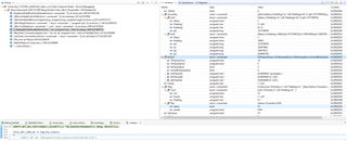

    I have debugged the driver file and see the below error message.
    sl_NetAppDnsGetHostByName is failed to run only in the OTA library.
    It is working well if I run in the main project like below.
    Please help me to resolve this issue.

  • in the Stack view, please check where it fails in _SlDrvMsgWrite.
    Also check what is the URL that was used during this (OTA) DNS query (and try to test it from your test application).
    This is very strange issue if it only happens to you. Maybe something in the otauser.h settings.

  • Hi Kobi,
    A test application with the same host name works fine.
    It is unable to get the IP address while executing the same code from the OTA Library function.
    It struck while receiving the response in the below function and threw a fatal error.
    Does the issue is related to ipV4 or ipV6?
    Could you please take a look at the screenshot and let me know any suggestions?
    Robert
  • As i asked before, the error starts in _SlDrvMsgWrite so if you stand on this when showing the Debug (stack) view - we can see the exact line where the error was detected.
    Are you saying that if i'll just take the cloud OTA from SDK5.20 with Dropbox settings (what OS and toolchain are you using), i should expect to see the same issue? You didn't do any changes to the application or the library (other the otauser settings)?
