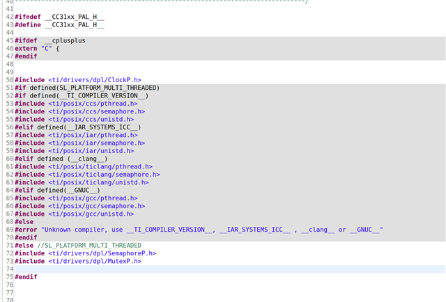

  • yes SL_PLATFORM_MULTI_THREADED is for the host driver,  not the application layer. but I'm including #include <ti/drivers/net/wifi/simplelink.h>
    inside simplelink.h #include <ti/drivers/net/wifi/porting/user.h> is there and inside user.h #include <ti/drivers/net/wifi/porting/cc_pal.h> is included
    In cc_pal.h file (below image)   SL_PLATFORM_MULTI_THREADED not defined because project don't have -D SL_PLATFORM_MULTI_THREADED flag
    because of this  different files are getting included.
    this is just an example, like this many files are wrongly included even though library(simplelink.a) in build with -D SL_PLATFORM_MULTI_THREADED flag
  • Strange, for me simplelink.h shows as if it is defined. Not sure were it takes it from. If you add this SL_PLATFORM_MULTI_THREADED, does it execute as expected?

    can you send me a screenshot of simplelink.h line  number 817?
    Yes after adding SL_PLATFORM_MULTI_THREADED it is working as expected.
