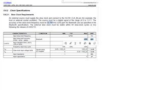

Please see the CC2564C 32K PPM.
Is the +- 250 PPM or the +- 25PPM?
Since customer found this value 250 is too huge.
please comment, thanks.
BR Rio

    Thanks for reaching out. +-250ppm is the correct value for the slow XTAL. Customer maybe confusing this spec with the fast XTAL spec(Only +-20ppm) which is a bit more relaxed than the slow clock. The BT Core Specifications states that the slow clock (a.k.a "sleep clock") must be less than or equal to +-500ppm which our +-250ppm spec clock meets.
    Customer can read more about this here
