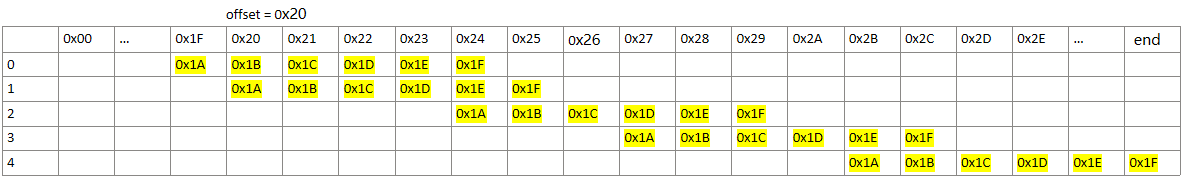

  • The custom packet filter allows a pattern to be matched at any location within a network frame, as long as it appears after a specified offset.
    When such a frame is received, the SMM will wake up from suspend, regardless of the exact position of the pattern beyond that offset.
    For example:
    pattern: 0x1A 0x1B 0x1C 0x1D 0x1E 0x1F
    offset: 0x20
    The system searches for a specific pattern(0x1A 0x1B 0x1C 0x1D 0x1E 0x1F) in the network frame starting at offset 0x20 through the end of the frame. If a match is found, the SMM wakes up from suspend.
    The frame with index 0 cannot wake up SMM while the frames with index 1, 2, 3, and 4 can wake up SMM.

    The meaning is that network packet frames with indexes 1, 2, 3, and 4 can wake up the system, while the frame with index 0 cannot wake up the system

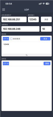

    The pattern offset is relative to the payload position, when I set the custom filter to 31:32:34:34:35:36 with the following command:
             echo "31:32:33:34:35:36" > /sys/class/net/wlan0/device/wowlan_pattern_search
    The system can be waken up by udp or tcp package with data (0x31, 0x32, 0x33, 0x34, 0x35, 0x36). In this case, the offset is 0.
    But when i set the offset > 0 with above same filter and the send the same tcp or udp message, the system can also be waken up.
    for example:
       echo "10+31:32:33:34:35:36" > /sys/class/net/wlan0/device/wowlan_pattern_search
    I think this is not right. I think the system can only be waken up when the offset is set to 0.
    Tcp message and udp message is as follows:

         The following is my test steps:
         1. connect wifi ap: AUSU_2.4G_LIN
         2. execute the command:  echo 1 > /sys/class/net/wlan0/device/wowlan_mode
         3. execute the command: echo 1 > /sys/class/net/wlan0/device/wowlan_pattern_clear && echo "42+74:02:e1:20:ec:64" > /sys/class/net/wlan0/device/wowlan_pattern_search
         4. execute the command: echo mem > /sys/power/stat , to suspend sysmtem
         5. Send UDP packet to the device via my phone, and then the device waked up immediately.

  • Hi Sabeeh,
         We use this app named 'Network Kit' on my iphone while reproducing this issus. The parameters as following:
        I hope it can help you reproduce this issue.
  • In addition to the customized packet filter set above, we didn't set any other packet filters.
