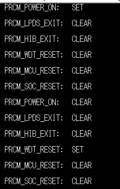

  • Hi KS.
    Can you run the watchdog driver example in the SDK? I couldn't use your code because it gave me a bunch of just normal compilation errors so I ran the watchdog example and used your resetCause printout logic. In my experiment using the example, I reset my board once and then triggered the watchdog reset afterwards and below is my terminal output.
    I hope this helps.
