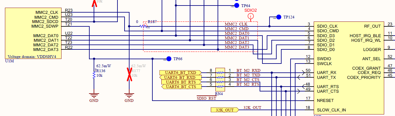

Hello
We have a bespoke board based on the AM62L and have CC3351MOD connected to the SDIO2 interface for WiFi and UART6 interface for Bluetooth.
We are using the Ti Linux kernel release 11.02.11 https://github.com/TexasInstruments/ti-linux-kernel/archive/refs/tags/11.02.11.tar.gz
Combined with the cc33xx latest release https://dr-download.ti.com/software-development/driver-or-library/MD-UoRUAALCjn/1.0.2.10/cc33xx_linux_package_1_0_2_10.run
Kernel has been configured to add
CONFIG_MAC80211_DEBUGFS=y
CONFIG_BT_DEBUGFS=y
CONFIG_BT_TI=n
CONFIG_BT_TI_SDIO=n
CONFIG_BT_TI_UART=m
Checking through the kernel source it looks like all the patch changes, as suggested in https://github.com/TexasInstruments-Sandbox/cc33xx-linux-mpu-ports/blob/main/ti-linux-6.12.y/0001-drivers-cc33xx-update-to-1.0.2.10.patch#L271
have been applied already to the ti 11.02.11 kernel.

I am also performing the suggested steps of bringing the wifi online first before enabling the bluetooth via debugfs:
ifconfig wlan0 up
echo 1 > /sys/kernel/debug/ieee80211/phy0/cc33xx/ble_enable
checking hci devices with hciconfig produces no output/no devices found.
Can you please advise of any other places to look at why the blutooth is not initialising?

  • Further investigation shows some serial communication from the module to AM62L when setting the ble_enable debug node:
    The pattern 0xFF 0xFF 0x02 0x04 0x2A 0x00 0x00 is sent once and no other activity.

  • Issue has been located.
    Device tree error in declaration for the serial port direction.
    Output set to Input now for RX and CTS and we have comms.
