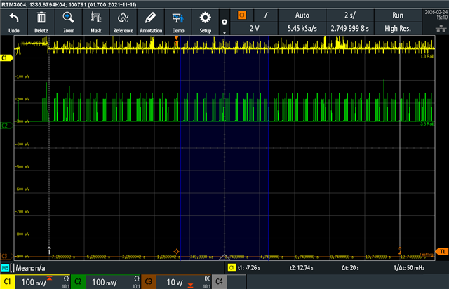

    This is a successful connect. I've using current-sense-resistors on the 1.8V rail (Yellow trace) and the 3.3V rail (Green trace) to monitor current consumption. The initial activity is doing the role up and initial connect command. Then there's a pause, and then the connection is successful with more clear activity. I stopped the capture early, since there was no reason to continue.
    In the log you can see it go through every step appropriately, with the P2P connect command executing and then several WLAN EVENT HANDLER lines about the connection associating and then being successful.

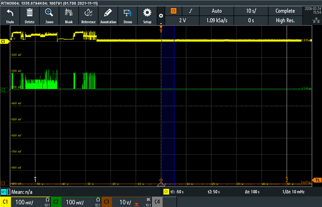

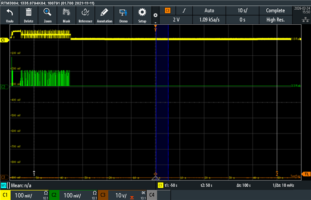

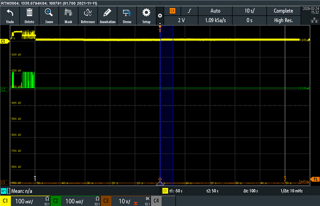

    This is the scope capture of the power rails when the connection never completes and then times out. You can see the initial activity at the beginning, then the 3.3V rail drops to no current and the 1.8V has a low pulse. It's almost like it thinks it's found something, and then it gives up when it should be connecting.
    The log looks like it follows that pattern. The line "P2P Scan completed event arrived" happens, then a "WLAN_EVENT DISCONNECT" and the P2P Connect line, like above. Then it sits there until it times out and proves the "Timeout expired" line.

    I have also seen where the pulses continue on the green ages, but it still doesn't connect. This capture is on a much shorter time scale though.
    Another timeout capture:

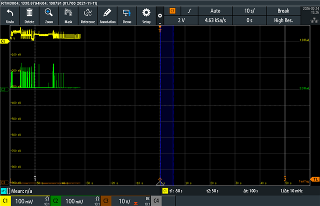

    A capture featuring a successful connection and then I restart both boards and attempt a new connection that times out:
    I kind of hard coded some commands to do all this with a button press, so it's possible there's session info that is normally added as part of entering it as a terminal command that I'm missing. Something that wouldn't cause a compilation error but might make connections more unstable.
