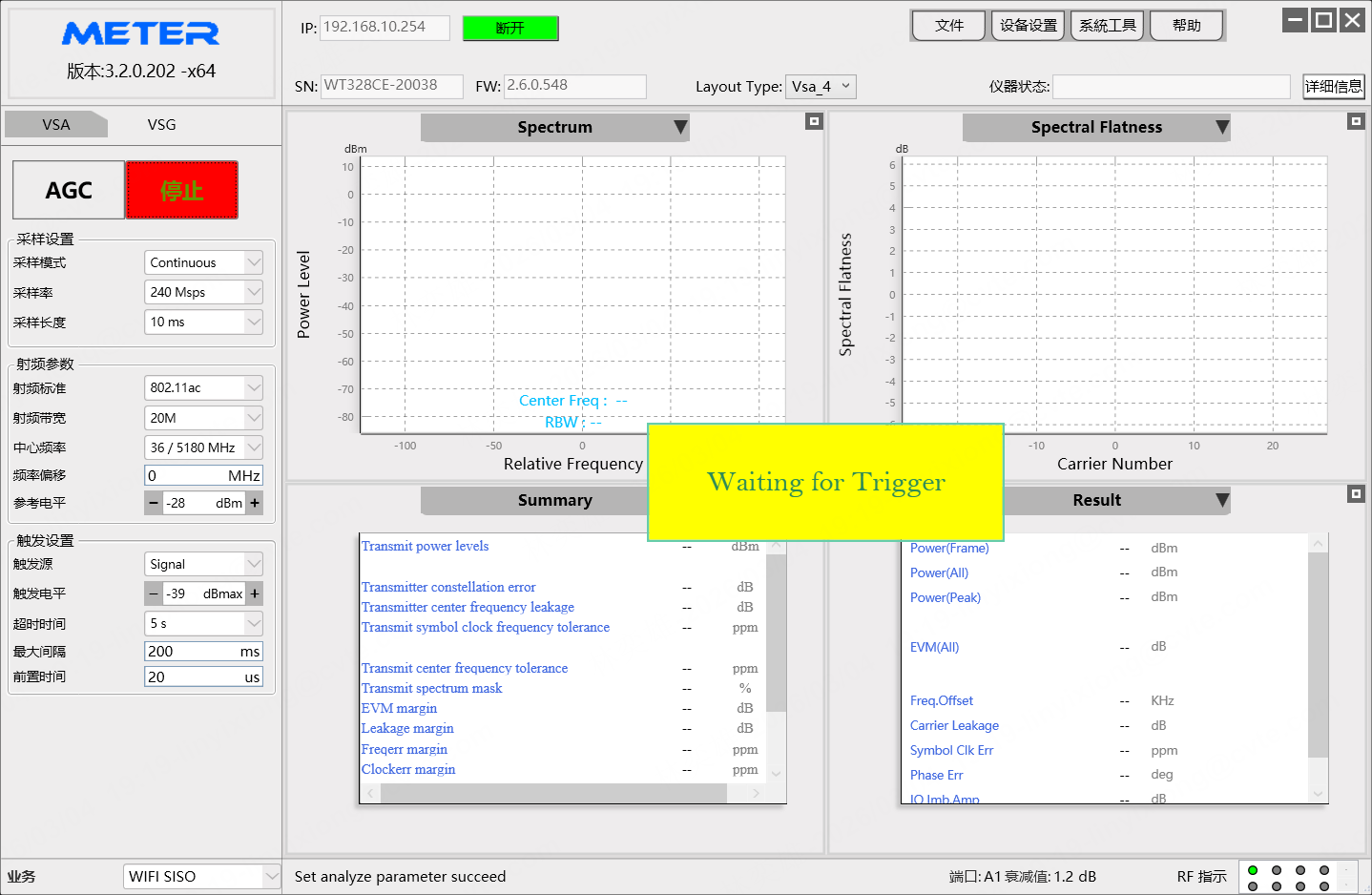

    After disabling Wi-Fi 6, I noticed that the 802.11ac mode also disappeared. Specifically, I can no longer detect the  RF signal for ac mode, and the logs captured with the network packet capture tool no longer show VHT either. Why is this happening? I disabled Wi-Fi 6 by setting HE_Enable to 00 in the cc33xx-conf.bin file.
