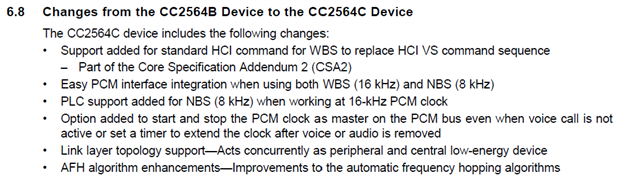

Is there a more detailed information available about the changes made between cc2564B and cc2564C hardware?
The cc2564C datasheet mentions in chapter 6.8 some differences.
Are there also updated vendor specific commands available, which address changes in the CC2564C firmware?
Are there any enhanced documents available to interpret the firmware messages beside the HCI commands to explain e.g. the DCF TX Buffer messages and so on more in detail?

  • Could it be, that there's an issue due to changes around the PLC and PCM interface mentioned in the datasheet?
    Is there documentation available about the changes in the VS commands?
    I guess there must be a change because of this statement:
    Option added to start and stop the PCM clock as master on the PCM bus even when voice call is not
    active or set a timer to extend the clock after voice or audio is removed
