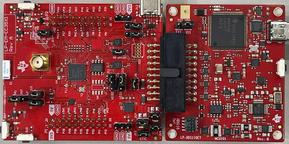

Hi TI team,
I recently purchased two evaluation kits from the TI website:
  • LP‑EM‑CC35X1 Rev A
  • LP‑XDS110ET
Both Type-C ports on the boards are connected to my PC.
My goal is to run the AT command example on the EVK to verify basic Wi-Fi functionality before developing my own Wi-Fi module based on CC3551E.
However, I am encountering issues when trying to debug or access the target memory.

Debug Failure in CCS
When I run Debug Project, the program fails to load to the target.
Debug log:
CS_DAP_0: FlashDeviceOsprey:: Flash loader: CC35xx_FLASH_LIBRARY_VERSION 1.2.0.13
CS_DAP_0: FlashDeviceOsprey:: FlashDeviceOsprey.cpp last changed: Nov 10 2025 18:48:17
File Loader: Verification failed: Could not write 0x14002000: target is not connected
GEL: File: ...\at_commands_LP_EM_CC35X1_freertos_ticlang.out: Load failed.

UniFlash is able to detect the EVK, but when attempting to read memory I get the following error:
Error connecting to the target:
(Error -614 - (3:16:1))
The target indicates there is an error condition from a previous SWD request.
Clear the error condition, and try the SWD request again.
(Emulation package 20.4.0.3756)

EVK configuration screenshot:
