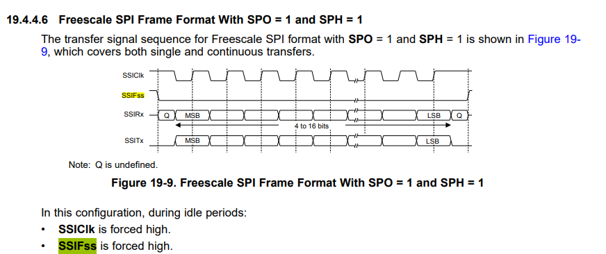

    The pin for SSIFss is not set in CC2538 is used (as configured at system startup).
    In this state, transmission/reception starts when SSI is enabled, SSI SR goes to BSY, and data transmission starts by CLK reception, so it is expressed as always active (low state). Customer said they do not know whether the register actually transitions from idle because there was no description when SSIFss was not set.
    Here is the mode they are using:

    There are 3 phenomenons and it is always the very beginning or very end of one of the processes.
    1. The last byte in 256 bytes frame is not sent
    2. The last byte which is not sent in 256 bytes will be sent in the next 8bytes frame
    3. If the clock increases by 1 bit due to noise or false positives when receiving 16bytes frames. At the time of 256 bytes frame transmission, the first byte is (0x00) empty data. When the 8 bytes frame is sent, the first byte is the last data to be sent in 2. After that, it is transmitted in a form that is offset by one byte.

  • once or multiple
    This was a clarifying question in my previous message, I assume once until otherwise informed
    Are 1, 2, and 3 mutually inclusive?  As in the the last byte not being sent (1) is always caused by the clock noise causing the first byte being empty data (3)? None of the examples provided show byte errors at the beginning without supposed clock false positives.
    I would expect that a clock increase by 1 bit should result in all data being bit-shifted, not one entire 0x00 byte shift.  Nevertheless, the behaviors observed are more indicative of clocking issues provided from the host than the DMA/SPI implementation on the CC2538.  You mentioned that there is no CS which is also contributing to the problem in this case.  This is why start of frame (SoF) and cyclic redundancy checks (CRC) are recommended for every data packet to confirm when the message actually begins and verify its contents. If the byte errors occur at the very beginning or end then it seems plausible to work around as compared to missing a byte in the middle. The DMAUSEBURSTSET comments concern different approaches to DMA transfers which may not be effectual if the error occurs at the beginning or end, depending on further analysis of the behaviors.

    it means that the last byte which is not sent in 256 bytes frame should be still in the TX-FIFO or Shift Register so when they send the next 8 bytes frame, the first byte will be the last byte which is not sent in the previous frame.
    Do you agree on this?
    And here are their questions.
    1. Can they check whether any data is still in TX-FIFO or shift register using any registers?
    2. Can they clear the TX-FIFO or shift register using any library available?
    3. What is the trigger for TX-FIFO to send the data to shift register? Is it when the slave receiving master clock or any other trigger?
    It would be appreciated if you can share the hardware logic behind that.
    They just want to make sure the remaining data which is not sent is stuck at TX-FIFO or shift register.
    As you can see below, they refill the DMA before sending the master ready sign to send clock.
    To prevent the phenomenon 1 & 2 happens, they want to clear the TX-FIFO or shift register after sending the 256 bytes frame so when they start the 8 bytes frame, the previous frame will not affect the data.
    Please let me know if I misunderstand or any information you need.
    Kenley
  • I agree to their understanding.
    1. We had previously discussed the TFE bit of the SSI_SR register, which I believe applies too this case
    2. I don't see any registers SSI registers for clearing the TX FIFO.  You could have the master device request additional bytes through the clock line and determine whether any additional valid data is received.
    3. What I have available is from the TRM: "In slave mode, the SSI transmits data each time the master initiates a transaction. If the TX FIFO is empty and the master initiates, the slave transmits the eighth most-recent value in the transmit FIFO. If less than eight values are written to the TX FIFO since the SSI module clock was enabled using the SSI bit in the SYS_CTRL_RCGCSSI register, then 0 is transmitted. Take care to ensure that valid data is in the FIFO as needed. The SSI can be configured to generate an interrupt or a µDMA request when the FIFO is empty...If the SSI is enabled and valid data is in the TX FIFO, the start of transmission is signified by the SSIFss master signal going low. The master SSITx output pad is enabled. After an additional one-half SSIClk period, both master and slave data are enabled onto their respective transmission lines. At the same time, SSIClk is enabled with a falling edge transition. Data is then captured on the rising edges and propagated on the falling edges of the SSIClk signal. In the case of a single word transmission, after all bits are transferred the SSIFss line is returned to its idle high state one SSIClk period after the last bit is captured. For continuous back-to-back transmissions, the SSIFss pin remains in its active low state until the final bit of the last word is captured and then returns to its idle state as previously described. For continuous back-to-back transfers, the SSIFss pin is held low between successive data words, and termination is the same as that of the single-word transfer"
    I think it would be best for them to have the master activate the clock one or two bytes past the existing 256 to make sure that the TX FIFO has been cleared.
