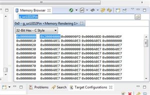

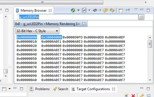

I am using cc3200 launchpad,during debugging i am unable to access the gpio registers.

Hi Arun,
Before you access peripheral registers, you need to enable the peripheral clock using PRCMPeripheralClkEnable() API.
Can you please confirm if your code does this call.
Pasting the code snippet (generated by TI Pinmux utility) from the blinky example :
PinMuxConfig(void)
// Enable Peripheral Clocks
MAP_PRCMPeripheralClkEnable(PRCM_GPIOA1, PRCM_RUN_MODE_CLK);
// Configure PIN_64 for GPIOOutput
MAP_PinTypeGPIO(PIN_64, PIN_MODE_0, false);
MAP_GPIODirModeSet(GPIOA1_BASE, 0x2, GPIO_DIR_MODE_OUT);
// Configure PIN_01 for GPIOOutput
MAP_PinTypeGPIO(PIN_01, PIN_MODE_0, false);
MAP_GPIODirModeSet(GPIOA1_BASE, 0x4, GPIO_DIR_MODE_OUT);
// Configure PIN_02 for GPIOOutput
MAP_PinTypeGPIO(PIN_02, PIN_MODE_0, false);
MAP_GPIODirModeSet(GPIOA1_BASE, 0x8, GPIO_DIR_MODE_OUT);

Hi Praveen Kumar
Yes I have enabled the peripheral clock using PRCMPeripheralClkEnable() API using TI pinmux utility.can u explain how to initialise launchpad Push buttons,how do i get interrupt for the button press
