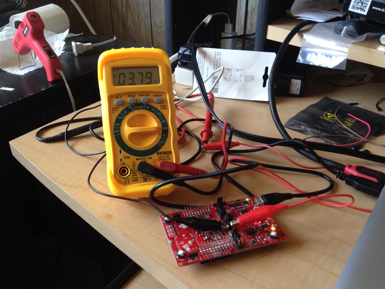

Myself S. Janarthanan,i am working on project in cc3200 which send sensor data for a particular interval of time and sleeps.
The power consumption on my board goes to 150mA on working that is using wifi,and comes to 4 mA on sleep,i can not reduce more than this power consumption,
i need to go below 1mA,can any one suggest me a way to do it?
I made most of the GPIO pins as PULLDOWN. i am new to this can some one guide me?
  • I am trying to do something similar, i have tried the LPDS mode and i have followed the GPIO parking recommendations in the docs. However, the chip current in the Launch pad is not going below 4.1mA.
    I am measuring the above current in J12. The code is written in energia.
    Much appreciate any help on this matter.
  • Just an update on the above, I moved to using CCS (from energia) and tried out the idle_profile_nonos. The HW is CC3200 Launchpad XL.
    After the cc_idle_task_pm(); is invoked i still read 3.76mA? I am not sure what i am missing. I am trying to bring the power down to 1mA is that possible?
    Hibernate works fine, the only problem is i have a sensor connected to my board and even though i have a GPIO to switch the sensor off, once i go in to hibernate i lose the GPIO state and my sensor comes ON and starts drawing power.
    Can any PM framework experts help me out here.
  • Janarthanan, Which board are you using for these measurements? TI's LP or your custom board?
    Junaith, Which measurement equipment are you using to measure the LPDS currents? Can you please send a screen capture of this equipment showing above current numbers?
    -/Praneet
  • Yes,am using custom board. In that I pulled most of the GPIO's to ground, but the processor itself consumes 4.1mA
  • Thanks. Can you please answer the second part of my questions as well?
    -/Praneet
  • please find the picture below. The multimeter can measure a max of 400mA in the current mode i have set. Code is idle_profile_nonos (SDK 1.1.0)
  • I have shown a video link of my video,which will show the power consumption of my board,see it and let me know what other details you want.
    Thanx in advance :-)
    https://youtu.be/gdJEOK9VwoQ
  • Janarthanan, Junaith,
    In 'Idle Connected' mode, the device wakes up intermittently (usually 100ms) to receive the beacon and then enters LPDS. Multimeter cannot be used for these measurements - Please refer 'processors.wiki.ti.com/.../CC3200_Current_Measurements' for details on the current measurement methods on CC3200-LAUNCHXL board.
    -/Praneet
  • Praneet thanks for the response, i am interested in keeping it in LPDS for 15 minutes or so, can u suggest an example. I dont want the network, i just want to save power.
    Also whats the expected current in LPDS mode for LAUNCHXL (only the chip).
    thanks
    Junaith
  • Junaith, You can use 'idle_profile' sample application of the SDK w/o the part of code that configures the device to connect to an AP for putting the device in LPDS (.i.e. both NWP and APPS subsystem in LPDS mode). Please refer section 4.9 of CC3200's datasheet for the expected current numbers.
    -/Praneet

  • Is your device connected to AP?
    -/Praneet
  • yes praneet
  • Janarthanan,
    Then, as I pointed in my earlier post, multimeter cannot be used for these measurements since the current is non-static in this mode and the device wakes up intermittently from LPDS (usually 100ms) to receive the beacon - Please refer 'processors.wiki.ti.com/.../CC3200_Current_Measurements' for details on the current measurement methods while in 'Idle Connected' mode.
    -/Praneet
  • Here u go, i have modified the idle_profile code the firmware will directly go try to go in to LPDS mode and wont wait for Serial commands. I have attached the code for your reference, I dont see any difference, i still measure 3.8mA. Far off from 0.25mA specified in the datasheet.
    how do we confirm that the code places the chip in the right mode (esp the cc_idle_task_pm).
    Is it possible for someone to confirm that the attached code consumes 3.8mA

  • Praneet,I saw your link,and programmed the device without connecting to AP,and then sleeping the device in LPDS mode,still i am in 4mA
  • Please measure the current w/ the application that I shared in my last post, and share the numbers.
    FYI - On CC3200-LAUNCHXL_Rev4.1, I'm seeing below numbers w/ my sample application.
    -/Praneet
  • Thank you praneet. I have used your code and pulled down my board amps consumption to 0.28mA by using the code in CCS.
    I wanna do that in energia,can you figure a way for this?
    Thx in advance.
  • I've not worked w/ Energia and cannot comment. We will move this thread to appropriate forum.
    -/Praneet
  • Hi Janarthanan,
    Are you using Energia?
    Robert
  • HI Robert,
    Yes I am using energia.
  • Hi Praneet,
    Yes I am using Energia for my prototypes for now. As I am planning to deploy and collect some data from my sensors it will be helpful for me to lower the power consumption as much as possible in the sleep mode. I am using the calls in driverlib/prcm.c for LPDS mode, but the current is very high (4mA) even after the chip going in to LPDS mode.
    I noticed that you guys have ported some of the power manager code in the hardware/common folder in Energia 15. However, I don’t think its fully functional, I get linker error. I am not sure what im missing. Could you please help with the right example.
  • Parneet, thanks for the pointer, i was able to reduce the power consumption to 0.27mA
  • Hi Robert, i had the same question as Janarthanan on Energia 15, do you guys have the power management implemented in Energia. I just started playing around recently, looks like a great way to prototype and validate concepts.
    Please let us know about the PM details.
    Junaith
  • Energia does not have power management implemented at the moment. You could however use simpelink API's in Energia to put the cc3200 into low power. Simply include the header file. Parneet can probably give pointers for what API's to use.
  • Parneet could you advice on the modules that need to be ported for Power Management Framework. I am trying to get PM working in Energia.
  • Janarthanan, I am working on putting the low power modes into Energia. It seems that you already have something working. Could you please share your code? This will help me a lot with speeding things up.
    Thanks!
    Robert From Energia
