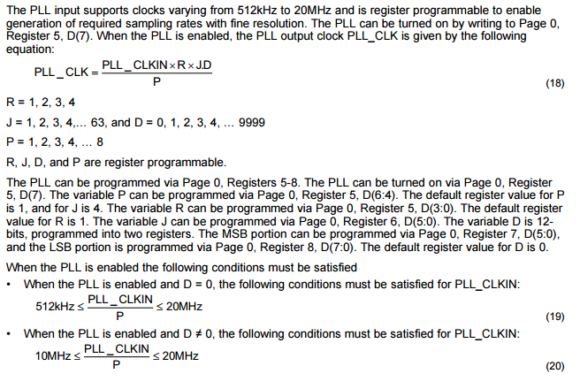

And I dont know how to configure the PLL as right configuration. Which value of MCLK, P, R, J, NDAC, MDAC... and so on
So, how to calculate these value (D=0???)
Can you please help me with the right Code for 44.1kHz and/or 48kHz please?

  • Hi Huan,
    You need to make following changes for 44.1/48 KHz 16-bit stereo PCM:
    1. Add below code lines in AudioCodecConfig() after “if(bitClk == 512000)”
    else if(bitClk == 1536000 || bitClk == 1411200)
    AudioCodecPageSelect(TI3254_PAGE_0);
    AudioCodecRegWrite(TI3254_CLK_MUX_REG, 0x03); // PLL Clock is CODEC_CLKIN
    AudioCodecRegWrite(TI3254_CLK_PLL_P_R_REG, 0x91); // PLL is powered up, P=1, R=1
    AudioCodecRegWrite(TI3254_CLK_PLL_J_REG, 0x38); // J=56
    AudioCodecRegWrite(TI3254_CLK_PLL_D_MSB_REG, 0x00); // D = 0
    AudioCodecRegWrite(TI3254_CLK_NDAC_REG, 0x82); // NDAC divider powered up, NDAC = 2
    AudioCodecRegWrite(TI3254_CLK_MDAC_REG, 0x87); // MDAC divider powered up, MDAC = 7
    AudioCodecRegWrite(TI3254_DAC_OSR_MSB_REG, 0x00); // DOSR = 0x0080 =
    AudioCodecRegWrite(TI3254_DAC_OSR_LSB_REG, 0x80); // DOSR = 0x0080 = 128
    AudioCodecRegWrite(TI3254_CLK_NADC_REG, 0x82); // NADC divider powered up, NADC = 2
    AudioCodecRegWrite(TI3254_CLK_MADC_REG, 0x87); // MADC divider powered up, MADC = 7
    AudioCodecRegWrite(TI3254_ADC_OSR_REG, 0x80); // AOSR = 128 ((Use with PRB_R1 to PRB_R6, ADC Filter Type A)
    2. In AudioCaptureRendererConfigure() replace 512000 with 1411200 for 44.1KHZ and 1536000 for 48KHz
    3. In main.c pass 44100 or 48000 in place of 16000 as argument for AudioCodecConfig()
    4. In main.c pass 44100 or 48000 in place of 16000 as argument for AudioCaptureRendererConfigure()
    As don't have expertise on Audio codec, so it is best to post query in TI-Audio codec((AIC3254) ) forum to know how to configure PLL related configuration.
    Aashish
