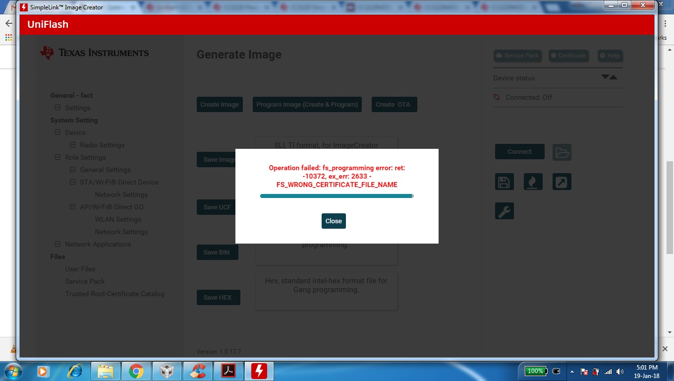

I am using CC3220MODASF12MON module on a custom board.
I am getting an error when I try to program my code as attached.
The board connects, I am loading an OOB image with minor modifications, and when I program the image, it gives below error.
Request your support.
P.S: The UART connection is dispalyed as OFF while it is programming, is this normal?
  • I also tried to flash the default "C:\ti\simplelink_cc32xx_sdk_1_50_00_06\examples\rtos\CC3220SF_LAUNCHXL\demos\out_of_box\uniflash\OOB_SF_tirtos\OOB_SF_tirtos", but i am not able to load this example file, and the image creator mentions that "Maximum file size is exceeded". I am not able to proceed ahead.

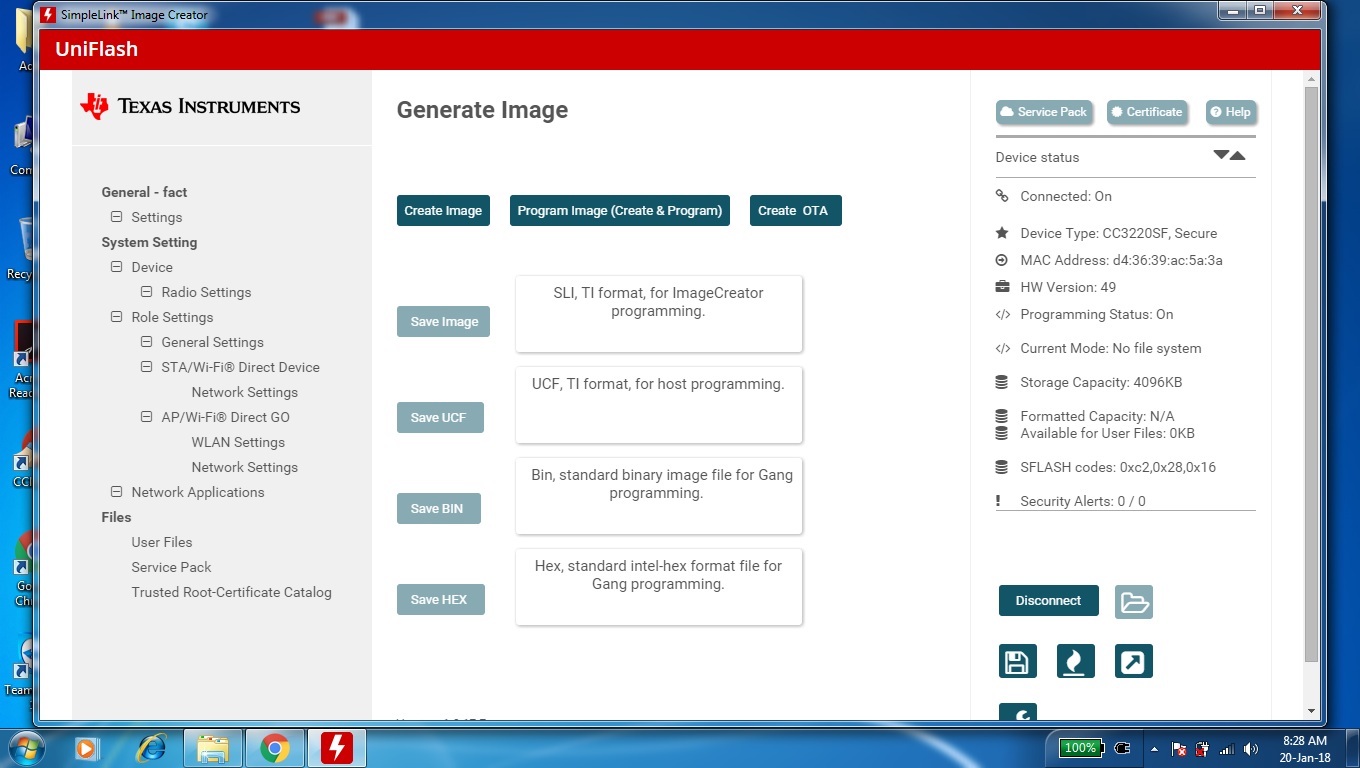

  • Hi Kevin,
    I have the SOP jumper set to flashing mode. "100" on the launchpad.
    I am using the project seeting in "Production" mode.
    Have connected TX, RX and RST pins of XDS110 debugger on launchpad to my custom boad.
    But, when i try to flash the OOB, i get the above error.
    I am able to connect and read the device MAC and other details, which get displayed as below.
    Vijay
  • Vijay,
    Can you share what User files you are uploading? the error you are getting is regarding the certificate you are uploading with the mcu image. You need to upload a certificate, and have the MCU use the private key for that certificate to program. you can follow the steps described by Kevin above to accomplish this.
    Also make sure you are including the trusted Root-Certificate Catalog as well.
