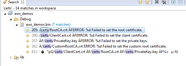

Hello while following the AWS FreeRTOS guide with CC32220SF, I'm having some problems related to Certification files. Here's is the terminal dump:

12 4353 [pthread] [SimpleLinkSockEventHandler ERROR]: Root CA in file system did not sign the chain.
13 4356 [pthread] [SimpleLinkSockEventHandler ERROR]: Handshake Failed - socket 0, reason: -688.

Also, reading here: https://e2e.ti.com/support/wireless-connectivity/wifi/f/968/t/602961, I looked for certificate_sl, but instead found this.
I suppose it is related to the fact that Certificates are hardcoded?
Anyway, I post here for the given case someone in the TI community has had this issue and could help me with my problem.
