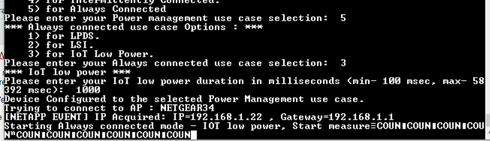

CC3235SF consistently locks up or resets itself, ranging anywhere from a few minutes to several hours of operation. We encountered this as we were building some very basic continuous tests side by side with the CC3220SF, which on the other hand works perfectly fine with the same firmware (re-targeted for CC3220SF obviously). The failure modes are as follows:
  • MCU stops responding then power draw jumps in the tens of milliamps rather than microAmps, GPIOs go dead, Serial Console goes dead and locks on last printed message. However NWP continues to respond to ICMP and will reconnect to WiFi quite fine, or
  • SoC resets itself for no apparent reason
So we decided to go back to basics by working from a supplied SDK demo, and it appears any of the supplied power_measurement_CC3235SF_LAUNCHXL variants replicates this failure: they show the SoC locking or reseting when left on. Our test:
  • CC3220SF LAUNCHXL as a control side-by-side: perfect runs indefinitely and maintains Low Power WiFi connected,
  • CC3235SF: We tried two different Eval Boards even to rule out hardware issues, tried powering it from a lab power supply, tried disconnecting all JTAG headers and peripherals. Same outcome.
We can replicate this by importing power_measurement_CC3235SF_LAUNCHXL_tirtos_ccs in CCS10, set WiFi credentials and then Load the firmware. To go further we added a serial console print in the main loop, to generate UART activity every few seconds, see file attached. When running, on the serial console select 5 -> 3 -> enter 1000 for SL_WLAN_IOT_LOW_POWER_POLICY. Let the board run and it eventually dies or resets.

void setUseCase(void)
    char sel[2];
    UART_PRINT("*** Power management use case Options : *** \n\r");
    UART_PRINT("    1) for Hibernate.  \n\r");
    UART_PRINT("    2) for LPDS.  \n\r");
    UART_PRINT("    3) for Transceiver Mode  \n\r");
    UART_PRINT("    4) for Intermittently Connected.  \n\r");
    UART_PRINT("    5) for Always Connected  \n\r");
    UART_PRINT("Please enter your Power management use case selection:  ");
    GetCmd(sel,sizeof(sel));
    UART_PRINT("\n\r");
    PowerMeasure_appData.useCase = (UseCases)(atoi((const char*)sel) - 1);
    return;
//! \brief    Get from the user the selected Always connected use case.
//! \param  None
//! \return None
void setAlwaysConnectedUseCase(void)
    char sel[2];
    UART_PRINT("*** Always connected use case Options : *** \n\r");
    UART_PRINT("    1) for LPDS.  \n\r");
    UART_PRINT("    2) for LSI.  \n\r");
    UART_PRINT("    3) for IoT Low Power.  \n\r");
    UART_PRINT("Please enter your Always connected use case selection:  ");
    UART_PRINT("\n\r");
    PowerMeasure_appData.alwaysConnectedUseCase =
        (AlwaysConnectedUseCases)(atoi((const char*)sel) - 1);
    return;

                        ASSERT_ON_ERROR(status);
                    break;
                default:
                    break;
            setIpAddrAllocMode(IP_ADDR_ALLOC_MODE);
            break;

        status =
            sl_NetCfgSet(SL_NETCFG_IPV4_STA_ADDR_MODE, SL_NETCFG_ADDR_DHCP, 0,
                         0);
            /* Disable the "fast renew feature" */
        status =
                         SL_NETCFG_ADDR_DISABLE_FAST_RENEW,
                         0,
                         0);
            break;
        case DHCP_FAST_RENEW_NO_ACK :
        status =
                         0);
            /* Enable the "fast renew feature" + "NO wait" */
        status =
                         SL_NETCFG_ADDR_ENABLE_FAST_RENEW,
                         0,
                         0);
        status =
                         SL_NETCFG_ADDR_FAST_RENEW_MODE_NO_WAIT_ACK,
                         0,
                         0);
            break;
        case DHCP_FAST_RENEW_WAIT_ACK :
        status =
                         0);
            /* Enable the "fast renew feature" + "wait ack" */
        status =
                         0,
                         0);
        status =
                         SL_NETCFG_ADDR_FAST_RENEW_MODE_WAIT_ACK,
                         0,
                         0);
            break;
    return(status);
//! \brief This function practice Transceiver mode.
//! \param None.
//! \return 0 on success, -ve otherwise.
int32_t transceiverMode(void)
    int32_t status = -1;
    int32_t socketId;
    int32_t idx;
    prepareDataFrame(PowerMeasure_appData.port,PowerMeasure_appData.ipAddr);
    status = sl_Start(0,0,0);
    if (CCA_BYPASS)
        /* bypass the cca */
        socketId = sl_Socket(SL_AF_RF,SL_SOCK_RAW,0);
    else
        /* consider cca */
        socketId = sl_Socket(SL_AF_RF,SL_SOCK_DGRAM,0);
    for (idx = 0;idx < NUM_OF_PKT; idx++)
        status =
            sl_Send(socketId,PowerMeasure_CB.frameData,FRAME_LENGTH,
                    SL_WLAN_RAW_RF_TX_PARAMS(TAG_CHANNEL,
                                             TAG_FRAME_TRANSMIT_RATE,
                                             TAG_FRAME_TRANSMIT_POWER,
                                             1));
        usleep(5000);
    status = sl_Stop(SL_STOP_TIMEOUT);
    /* enter hibernate */
    powerShutdown(NOT_ACTIVE_DURATION_MSEC);
    /* this line is never Reached */
    return(status);
//! \brief This function practice Always connected mode.
//! \param None.
int32_t alwaysConnected(void)
    switch (PowerMeasure_appData.socketType)
        case SocketType_UDP :
        status = bsdUdpClient(PowerMeasure_appData.port,
                              PowerMeasure_appData.sockID);
            break;
        case SocketType_TCP :
        status = bsdTcpClient(PowerMeasure_appData.port,
            break;
        case SocketType_SEC_TCP :
        status = bsdTcpSecClient(PowerMeasure_appData.port,
            break;
    return(status);
//! \brief This function practice Intermittently connected mode.
//! \param None.
int32_t intermittentlyConnected(void)
    char queueMsg = 0;
    /* waiting for fast connect process to complete */
    while (queueMsg != STATUS_BIT_IP_ACQUIRED)
        mq_receive(PowerMeasure_CB.queue, &queueMsg, 1, NULL);
            status = bsdUdpClient(PowerMeasure_appData.port,ALWAYS_OPEN_SOCK);
            break;
            status = bsdTcpClient(PowerMeasure_appData.port,ALWAYS_OPEN_SOCK);
            break;
            status = bsdTcpSecClient(PowerMeasure_appData.port,ALWAYS_OPEN_SOCK);
            break;
    return(status);
//! \brief This function implement UDP client .
//! \param Port - socket port number; Sid - socket id,
//!        -ve if socket is already opened.
int32_t bsdUdpClient(uint16_t port, int16_t sid)
    int16_t         sockId;
    int16_t         idx = 0;
    if (sid < 0)
        /* Need to open socket  */
        sockId = sl_Socket(SL_AF_INET,SL_SOCK_DGRAM, 0);
        ASSERT_ON_ERROR(sockId);
    else
        /* Socket is already opened */
        sockId = sid;
    while (idx < NUM_OF_PKT)
        status = sl_SendTo(sockId,PowerMeasure_CB.frameData ,FRAME_LENGTH , 0,
                           (SlSockAddr_t *)&PowerMeasure_CB.ipV4Addr,
                           sizeof(SlSockAddrIn_t));
        if(status <= 0 )
            status = sl_Close(sockId);
        idx++;
    if (sid == ALWAYS_OPEN_SOCK)
        /* Next time, use a new socket */
    else
        /* store the current open socket id*/
        PowerMeasure_appData.sockID = sockId;
    return(0);
//! \brief This function implement TCP client .
int32_t bsdTcpClient(uint16_t port, int16_t sid)
    int16_t         sockId;
    int16_t         idx = 0;
    int16_t         status = -1;
    if (sid < 0)
        sockId = sl_Socket(SL_AF_INET,SL_SOCK_STREAM, 0);
        /* Make connection establishment */
        status = sl_Connect(sockId, ( SlSockAddr_t *)&PowerMeasure_CB.ipV4Addr,
        if(status < 0)
            sl_Close(sockId);
    else
        sockId = sid;
        status = sl_Send(sockId,PowerMeasure_CB.frameData ,FRAME_LENGTH, 0 );
        if(status <= 0 )
        idx++;
    else
    return(0);
//! \brief This function implement TLS/SLL on TCP client .
int32_t bsdTcpSecClient(uint16_t port, int16_t sid)
    uint32_t  cipher = SL_SEC_MASK_SSL_RSA_WITH_RC4_128_SHA;
    uint8_t method = SL_SO_SEC_METHOD_SSLV3;
    int16_t sockId;
    int16_t idx = 0;
    if (sid < 0)
        /* need to open new socket */
        sockId = sl_Socket(SL_AF_INET,SL_SOCK_STREAM, SL_SEC_SOCKET);
        status = sl_SetSockOpt(sockId, SL_SOL_SOCKET, SL_SO_SECMETHOD,
                                       &method, sizeof(method));
        if(status < 0 )
            UART_PRINT(" Failed to configure the socket \n\r");
        status = sl_SetSockOpt(sockId, SL_SOL_SOCKET, SL_SO_SECURE_MASK,
                &cipher, sizeof(cipher));
        if(status < 0 )
        /* If the user flashed the server certificate
           the lines below can be uncomment  */
        status = sl_SetSockOpt(g_SockID, SL_SOL_SOCKET,.
                 SL_SO_SECURE_FILES_CA_FILE_NAME,
                SL_SSL_CA_CERT, pal_Strlen(SL_SSL_CA_CERT));
        if( status < 0 )
            LOOP_FOREVER();
        /* connect to the peer server */
        if ((status < 0) && (status != SL_ERROR_BSD_ESECSNOVERIFY))
            /* ignore authentication error */
            UART_PRINT(" Failed to connect w/ server \n\r");
            LOOP_FOREVER();
        UART_PRINT(" Connection w/ server established successfully \n\r");
    else
        sockId = sid;
        status = sl_Send(sockId, PowerMeasure_CB.frameData, FRAME_LENGTH, 0 );
        if( status <= 0 )
            UART_PRINT(" [TCP Client] Data send Error \n\r");
        idx++;
    else
        /* store the current open socket id */
    return(0);
//! \brief    This function prepare the Data Frame & initialize IP address data
//!         struct            .
//! \param  Port & IP addressnn
//! \return None
void prepareDataFrame(uint16_t port,uint32_t ipAddr)
    uint16_t idx;
    for(idx = 0;idx < FRAME_LENGTH;idx++)
        PowerMeasure_CB.frameData[idx] = (signed char)(idx % 255);
    PowerMeasure_CB.ipV4Addr.sin_family = SL_AF_INET;
    PowerMeasure_CB.ipV4Addr.sin_port = sl_Htons(port);
    PowerMeasure_CB.ipV4Addr.sin_addr.s_addr = sl_Htonl(ipAddr);
//! \brief    This function Flush the given message queue            .
//! \param  Pointer to the queue & the size of the queue
int32_t powerMsgQFlush(mqd_t pMsgQ, uint32_t size)
    int32_t idx;
    char queueMsg;
    struct timespec ts;
    clock_gettime(CLOCK_REALTIME, &ts);
    for (idx = 0; idx < size; idx++)
        status = mq_timedreceive(pMsgQ, &queueMsg, 1, NULL, &ts);
    return(status);
//! \brief Task Created by main function.This task starts simpleLink, set NWP
//!        power policy, connects to an AP. Give Signal to the other task about
//!        the connection.wait for the message form the interrupt handlers and
//!        the other task. Accordingly print the wake up cause from the low
//!        power modes.
//! \param pvParameters is a general void pointer (not used here).
//! \return none
void mainThread(void *pvParameters)
    int32_t             status = 0;
    pthread_t           spawn_thread = (pthread_t)NULL;
    struct timespec     ts = {0};
    mq_attr             attr;
    uint32_t            mode = 0;
    pthread_attr_t      pAttrs_spawn;
    struct sched_param  priParam;
    GPIO_init();
    SPI_init();
    /* Configure the UART */
    InitTerm();
    /* initilize the realtime clock */
    clock_settime(CLOCK_REALTIME, &ts);
    /* Turn on user LED */
    GPIO_write(CONFIG_GPIO_LED_0, CONFIG_GPIO_LED_ON);
    /* clear SimpleLink Status */
    PowerMeasure_CB.slStatus = 0;
    /* Start the SimpleLink Host */
    pthread_attr_init(&pAttrs_spawn);
    priParam.sched_priority = SPAWN_TASK_PRIORITY;
    status = pthread_attr_setschedparam(&pAttrs_spawn, &priParam);
    status |= pthread_attr_setstacksize(&pAttrs_spawn, TASKSTACKSIZE);
    status = pthread_create(&spawn_thread, &pAttrs_spawn, sl_Task, NULL);
    if(status != 0)
        UART_PRINT("could not create simpleLink task\n\r");
        LOOP_FOREVER();
    /* sync object for inter thread communication */
    attr.mq_maxmsg = 32;
    attr.mq_msgsize = sizeof(uint8_t);
    PowerMeasure_CB.queue = mq_open("ConnectionFlag", O_CREAT, mode, &attr);
    if(((int)PowerMeasure_CB.queue) <= 0)
        UART_PRINT("could not create msg queue\n\r");
        LOOP_FOREVER();
    status = sem_init(&PowerMeasure_CB.sem,0,0);
    if (status != 0)
        UART_PRINT("unable to create the semaphore \n\r");
        LOOP_FOREVER();
    if (isWokenFromHib())
        UART_PRINT("Woken from Hib.\n\r");
        /* When waking from Hibernate we need to determine
           what use case the app exercises */
        if (getHibRetentionReg() == (uint8_t) UseCase_Transceiver)
            PowerMeasure_appData.useCase = UseCase_Transceiver;
        else
            PowerMeasure_appData.useCase = UseCase_IntermittentlyConnected;
    else
        /* Before turning on the NWP on,
        reset any previously configured parameters */
        IMPORTANT NOTE - This is an example reset function,
        user must update this function to match the application settings.
        status = sl_WifiConfig();
        if(status < 0)
            /* Handle Error */
            UART_PRINT("Power Measurement - Couldn't configure Network Processor - %d\n",status);
            LOOP_FOREVER();
        /* Displays the Application Banner */
        displayBanner();
        /* Turn NWP on */
        status = sl_Start(NULL, NULL, NULL);
        if(status < 0)
            /* Handle Error */
            UART_PRINT("sl_start failed - %d\n",status);
            LOOP_FOREVER();
        /* Unregister mDNS services */
        status = sl_NetAppMDNSUnRegisterService(0, 0, 0);
        if(status < 0)
            /* Handle Error */
            UART_PRINT("sl_NetAppMDNSUnRegisterService failed - %d\n",status);
            LOOP_FOREVER();
        /* Set Desired PM use case */
        setUseCase();
        /* configure device to the selected use-case */
        status = configSimplelinkToUseCase();
        /* trap for error */
        if(status < 0)
            LOOP_FOREVER();
        UART_PRINT(
            "Device Configured to "
            "the selected Power Management use case.\n\r");
        /* Connect To AP for first time, connected use cases only */
        if(PowerMeasure_appData.useCase == UseCase_AlwaysConnected ||
            PowerMeasure_appData.useCase == UseCase_IntermittentlyConnected)
            status = wlanConnect();
            /* Stay connected if the use case is always connected */
            if (PowerMeasure_appData.useCase ==
        startMeasureBanner();
    /* Flush connection Queue, inorder to start clean */
    powerMsgQFlush(PowerMeasure_CB.queue, 1);
    int count = 0;
    while (1)
        switch (PowerMeasure_appData.useCase)
            case UseCase_HIB :
                powerShutdown(MAX_INT);
                break;
            case UseCase_LPDS :
                if (status < 0)
                    UART_PRINT("unable to start the device \n\r");
                    LOOP_FOREVER();
                /* Enable LPDS policy */
                Power_enablePolicy();
                sem_wait(&PowerMeasure_CB.sem);
                break;
            case UseCase_Transceiver :
                UART_PRINT("Transceiving...\n\r");

    I've ran multiple test in parallel here on CC3235SF Launchpads and still cannot reproduce this issue. Have you made any modifications to the power settings in Sysconfig? Also, out of curiosity, do you get this same behavior when not using SL_WLAN_IOT_LOW_POWER_POLICY? Maybe try option 5->1 instead?
    The only odd consistency I saw across all tests was that the UART prints are wrong but I did not pay attention to them because it is not related to this issue.
