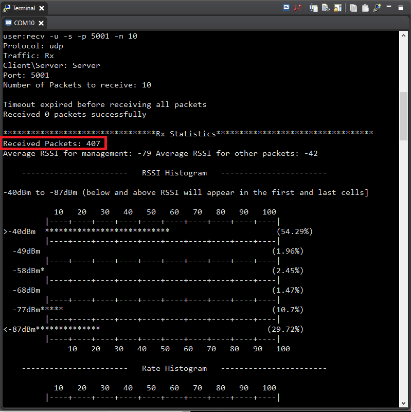

  • Hi Michael,
    Sorry for my rate reply.
    I executed your procedure and result was following.
    Could you tell me how to confirm whether CC3220 received the limited broad cast packet ?
    What kind of packets are expected to be included in the Received Packets surrounded by a red frame?
    U-SK

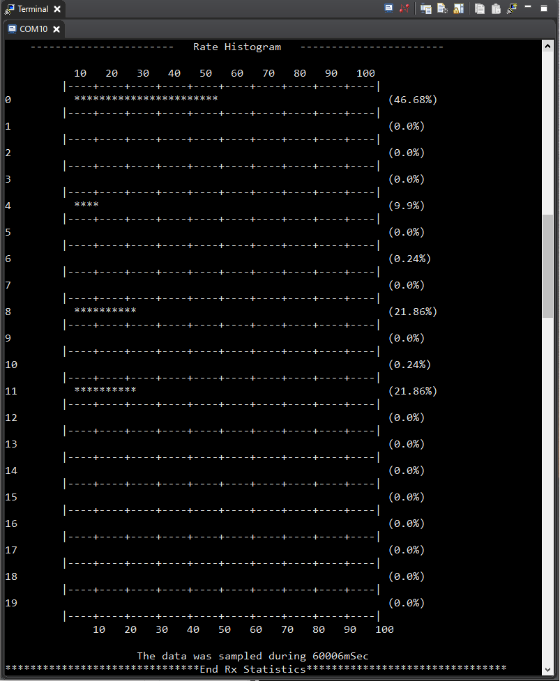

  • Hi U-SK,
    It seems like your device does not receive any broadcast packets successfully, as the program output indicates that there were 0 packets received successfully.
    The number of frames received as indicated in the RX statistics are the sum of all frames received. So this would mainly be management frames from the AP, power saving PSPOLL messages, etc. and not just UDP packets/data frames.
    What are you using on the PC to send the UDP packets to the CC3220? Are you able to verify that the UDP packets are actually transmitted by the PC on the air? I suggest you also try a different PC and sending mechanism to ensure that the issue isn't caused by the sending side.
