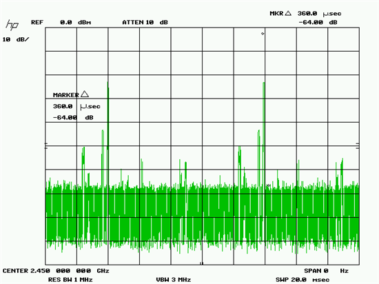

    I'm working with Paul here on getting this Bluetooth FCC testing done.  Another thing we're still working on is demonstrating frequency hopping for the FCC test.  According to the FCC, the test's purpose is:
     "to ensure that the RF energy of frequency hopping systems is hopping at a minimum defined rate.  This helps ensure sufficient time off to enable other frequency hopping devices to co-operate within this allocated band."
    Therefore, we need a command in which to have Bluetooth continuously transmit and hop through all the available channels.  From what I understand of the information on the TI wiki: http://processors.wiki.ti.com/index.php/Bluetooth_FCC_Mode#WL1271_.2B_ARM_Platforms ,  the commands provided there only transmit on one defined channel, but we need to have transmission hopping through all channels.
    This is what we expect to see in the frequency domain on the spectrum analyzer (Here we're zoomed into 3 channels).
    Could you provide us with a command to satisfy this test?
    Andre

  • Hi Bill,
    Thanks for you reply,  it got us very close!  We definitely have hopping on all channels now,  but since it's pinging (instead of transmitting) it's only doing short blips on each channel:
    It's only occupying each channel for a few microseconds at a time, but to demonstrate the FCC frequency occupancy requirement, we'll need to have each channel occupied for 675 microseconds as per Bluetooth spec.
    Would anyone happen to know how to make the Bluetooth chip "send" in the blind, without connecting to a real other device first?  I tried using l2test with the "connect and send" mode but since I had nothing to connect to, I couldn't get it to send.
    Andre

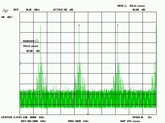

  • Hi Miguel,
    Thank you for your reply, it was very helpful!
    The commands that we are using now are:
    HCI_VS_DRPb_Tester_Packet_TX_RX for hopping (0x00), disabled RX, DH5, PRBS9 Random, max packet length, power level 15, whitening disabled, and PRBS9 init to 0x0000
    hcitool cmd 0x3F 0x185 0x00 0x00 0xFF 0x05 0x00 0x00 0x00 0x00 0x0F 0x01 0x00 0x00
    followed by
    Send_HCI_VS_Write_Hardware_Register 0xFF01, 0x0019180c, 0x0101
    hcitool cmd 0x3F 0x0301 0x0C 0x18 0x19 0x00 0x01 0x01
    I have several observations here:
    1. The instruction to  set Frequency Mode is (0x00 - Single Freq, 0x03 - Hopping) but I found that 0x03 produced no transmission, but 0x00, 0x01, and 0x02 produced hopping.  Could you please clarify this?
    2. I tried setting Packet Data Length to 0xFFFF, but that crashed the device.  I suppose 0 for Max Data Length would be the option we should use?
    However, the two questions that we have are:
    1. From what we see right now, the psuedo random sequence of hopping through all channels doesn't restart every cycle.  What we would like is for every hopping cycle through all the channels, we would like the pseudo-random sequence to start again from the same seed (init).  This would let us calculate the hopping frequency by measuring the duration between two visits of the same channel ( = time for one complete cycle of hoping all channels).  For this to work, the channels need to be visited in the same order every cycle.
    2. The pulse width at each frequency (duration for which each channel is held), was observed to be 50 - 100 microseconds.  We would like to have the pulse width set to 300 to 650 microseconds as per a typical Bluetooth device.
    Could you let us know whether the two questions I just mentioned could be solved through the setting of some parameter?
    Andre
  • Andre,
    I made a mistake in the previous post. The correct parameters are (I have corrected the previous post now):
    0xAA = Frequency Mode (0x00 - Hopping, 0x03 - Single Freq)
    I forgot to mention that for this command you do not need to send the HCI_VS_Write_Hardware_Register, but you must be sure that the initial conditions (no scans) are met.
    Regarding the "Packet Data Length", this would depend on the packet type that you select. For instance,  0-17 for DM1, 0-27 for DH1 and so on.
    For 1, the hopping sequence depends on different factors. Could you elaborate what you are trying to evaluate here?
    For 2, this will depend on the packet type.
    ~Miguel
  • Thanks Miguel!  We finally got it to work with DH1 and Packet Data Length set to 27:
    hcitool cmd 0x3F 0x185 0x00 0x00 0xFF 0x01 0x01 0x00 0x1B 0x00 0x0F 0x01 0x00 0x00
