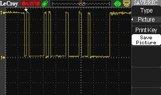

Verified Rx from host to wl1271 to be 4 bytes of TI specific code
RTS response from the wl1271 is going high to low
CTS is staying high at all times

    Analyzing the packets out of the IMX51 processor UartTx, they are both perfect 4bytes of data translating to TI device command(as specified by the Bluez Stack) and opperating at 115200 baud rate (8.6us per uart pulse width).  What is the reason that the WL1271 does not respond to our sent uart commands?

    When the HCI command is received correctly (115.2 kbps, 8 bits, stop bit 1, parity none) at the hci_rx of the wl1271, if powered up, the wl1271 will be responding.  Can you clarify  the statement "CTS is staying high at all times"? Is it host_cts or hci_cts? Setting the hci_rts high means the wl1271 is not ready to receive from the host. When the hci_cts is set high, the wl1271 stops transmitting.  As far as i know the hci_cts must be low to sent the response by the wl1271.
    Sinoj
  • Sinoj,
    "CTS is staying high at all time" - It is host_cts (imx515 cts)
  • Peter,
    If the host_cts (is connected to hci_rts) is staying high at all time and the processor is sending data to the wl1271 indicate that uart flow control is not working. Am i right?
