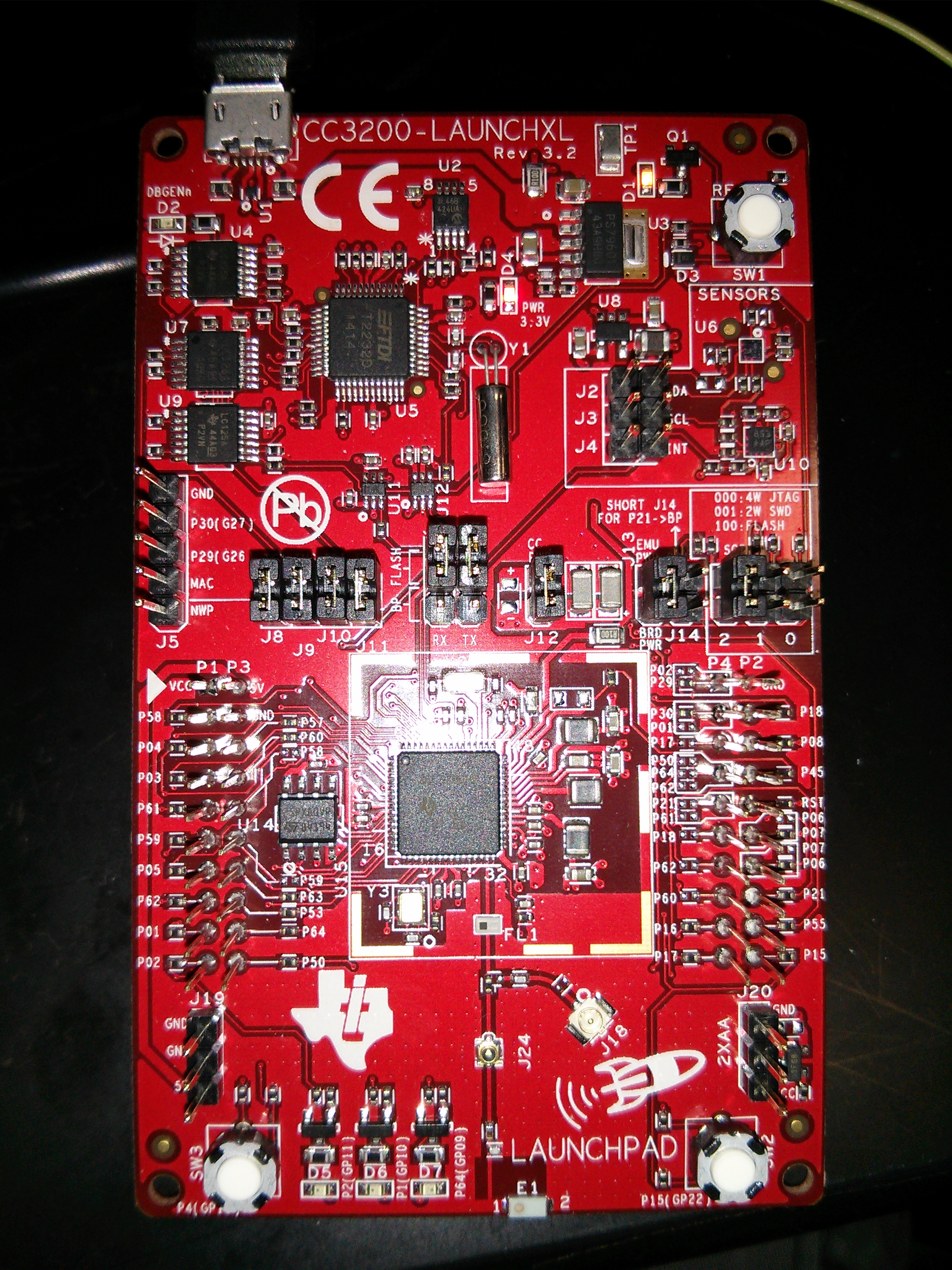

    • capture of the board. I want to verify jumpers

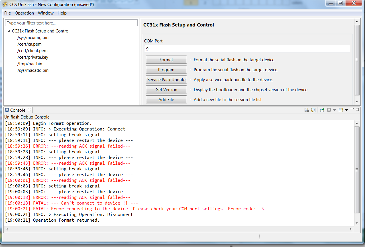

    • please show me the 'Console' screen on Uniflash while trying to flash something

    Here's a picture of the board. I've tried both SOP0 and SOP2 and they don't seem to work.
    And finally, here's the Uniflash console screen after attempting a format operation using COM9. I hit the reset button once when prompted, and it shows the same error every time.

  • Praneet,
    In this case, the board seems to be broken. TI representative would contact you offline for board replacement.
