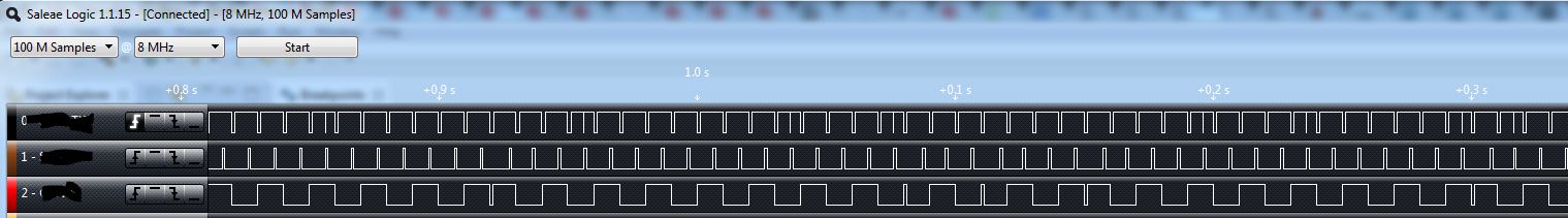

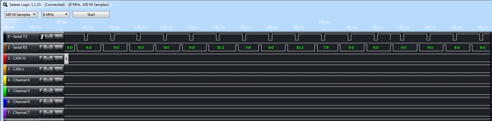

  • I connected my logic analyzer to make the timer jitter visible:
    channel 0 is the input signal on which the timer is started (at 6.2ms after falling edge), period is 10ms.
    channel 1 is the output signal triggered from my timer interupt, this on should be 9.0ms low, 1.0ms high (10ms period).
    The timer should be 9.0ms all the time! But sometimes, it jumps to 10.2. Interesting to see is that after a 10.2 there is always a 7.8. So it looks like the timer is sometimes too late, and because I have it fixed at 9.0, its corrected to 7.8. Is it safe to say that my Timer interrupt is hold up by something else?
    To get an idea about the occurance, I measured a lott of periods:
    10.2, 7.8, 10.2, 7.8, 9.0, 9.0, 10.2, 7.8, 9.0, 9.0, 9.0, 9.0, 9.0, 9.0, 9.0, 9.0, 10.2, 7.8, 9.0, 10.2, 7.8, 9.0, 9.0, 9.0, 9.0, 9.0, 9.0, 9.0, 9.0, 9.0, 9.0, 9.0, 9.0, 9.0, 9.0, 10.2, 7.8, 10.2, 7.8, 9.0, 10.2, 7.8, 9.0, 9.0, 9.0, 9.0, 9.0, 9.0, 10.2, 7.8, 9.0
    So in 510ms I got 8 occurances of the timer firing 1.2ms too late.....

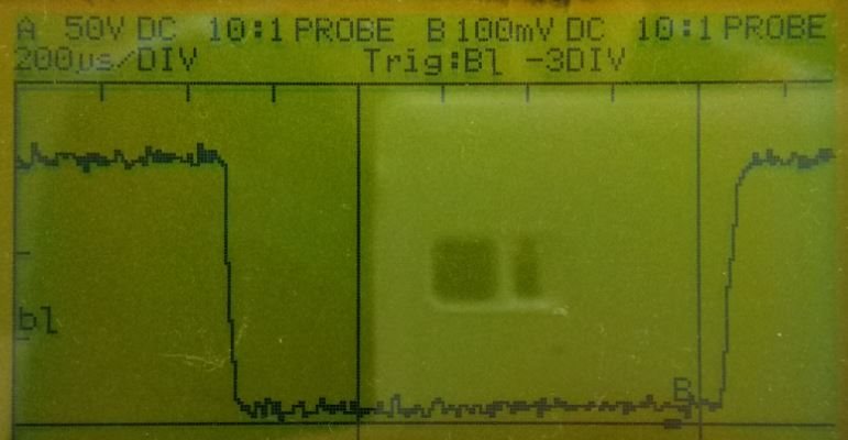

  • Well, the LA is just to make a random occurance visible, which is hard to trigger on a normal scope. I am 100% certain that my input sometimes triggers on the rising edge while I have programmed it to trigger only on falling edge! So this thread has no longer to do with the accuracy of the timer (though still an interesting question).
    I am using the normal launchpad board and I am using only the SW3 and GreenLed connection.
    I used the timer to make a 9ms high, 1 ms low signal and feed that through the greenled to SW3 and trigger on falling edge. This works without problems.
    When I connect my hardware that does the same, it sometimes triggers on rising edge.... See above LA pictures for proof. So I was thinking about noice offcourse. I connected a 100nF condensator and also put a ferrite in, but that did not help. On my scope the signal looks good. See picture below (this is without the 100nF, with the 100nF it is just a lot smoother but still the same problem):
    The signal is on channel B. I am using a 1:100 differential probe, so the voltage is actually 1V / div. This is the 1 ms puls that makes my SW3 input trigger sometimes on rising edge while I have programmed it on falling edge!
    Any ideas why it triggers on rising edge?

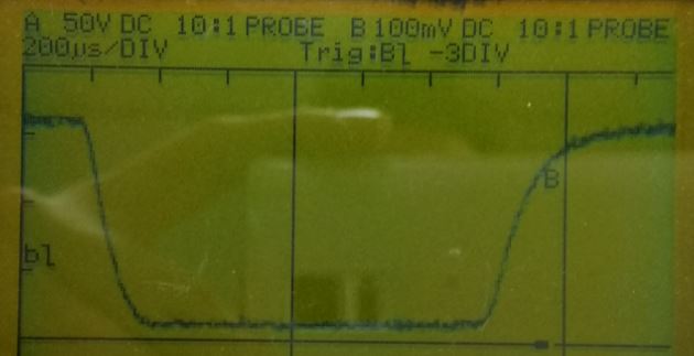

    Edit, following picture is the filtered 1ms signal (100nF condensator). Please explain why this one triggers on rising edge sometimes....

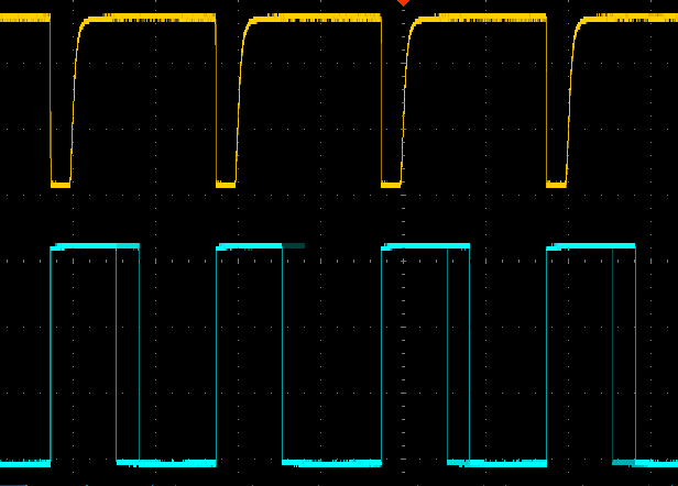

  • I am also facing the same issue. Uploading waveform. Needs some solution. Above signal is input to a GPIO and below one is output from a GPIO.
  • Hi anish, I suppose your yellow trace is from generator then cyan is from GPIO, good shoot.
    Generator pulse sync come to GPIO and interrupt is fired but we cannot see what happen due output is from timer so please try this, set GPIO on button interrupt and just reset on timer then repost scope waveform, in this case we cleanly can see if gpio interrupt is fired on falling edge or from raising too.
    Your scope has more traces than 2? if so adding another track set and reset when enter gpio interrupt service.
