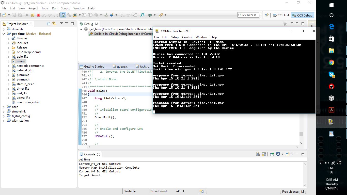

Hey guys I just got hold of the CC3200 I started with the get time example program everything works just fine except that the time displayed is wrong I have attached the screenshot of the output can anybody help
    Have you modified: GMT_DIFF_TIME_HRS & GMT_DIFF_TIME_MINS ?
    Please see: processors.wiki.ti.com/.../CC32xx_Info_Center_Get_Time_Application
    Gigi Joseph.
  • Yes I added the Gmt time difference now the time is right  but the date is a day ahead like it should 14 but its giving 15 is this due to 2016 being leap year?
  • Guys anybody can just give some  idea like  whats wrong
  • Hi Punit,
    Please refer to the GetSNTPTime function in main for the algorithm which converts the NTP (Network Time Protocol) packet from seconds since 1900 to a human readable date. A conversion error of this timestamp is likely causing the value to be a day off.
    Austin
  • Here is a fix this should give you right date and time base on your time zone.

  • Did this work for you let me know if you still have an issue.
  • by removing 1 from the date calculation will print you the start of month as 0, so, Instead of changing the calculation change the array that has number of days to 29 in 1st index behalf of 28.
    const char g_acNumOfDaysPerMonth[12] = {31, 29, 31, 30, 31, 30, 31, 31, 30, 31, 30, 31};
    but this is also not a full solution, because,this will work fine for leap year not for ordinary year.
    If you got any solution for that please share...
  • Yes I have refined the whole code to get it working disappointing that TI has shipped wrong example code
  • I too refined now only, Here is the change that i have done.

    // date
    // restore the day in current month
    g_sAppData.isGeneralVar += g_acNumOfDaysPerMonthNonLeapYear[iIndex];
    g_sAppData.uisCCLen = itoa(g_sAppData.isGeneralVar + 1,
    g_sAppData.pcCCPtr);
    g_sAppData.pcCCPtr += g_sAppData.uisCCLen;
    *g_sAppData.pcCCPtr++ = '\x20';
    // time
    g_sAppData.ulGeneralVar = g_sAppData.ulElapsedSec%SEC_IN_DAY;
    // number of seconds per hour
    g_sAppData.ulGeneralVar1 = g_sAppData.ulGeneralVar%SEC_IN_HOUR;
    // number of hours
    g_sAppData.ulGeneralVar /= SEC_IN_HOUR;
    g_sAppData.uisCCLen = itoa(g_sAppData.ulGeneralVar,
    *g_sAppData.pcCCPtr++ = ':';
    // number of minutes per hour
    g_sAppData.ulGeneralVar = g_sAppData.ulGeneralVar1/SEC_IN_MIN;
    // number of seconds per minute
    g_sAppData.ulGeneralVar1 %= SEC_IN_MIN;
    g_sAppData.uisCCLen = itoa(g_sAppData.ulGeneralVar1,
    *g_sAppData.pcCCPtr++ = '\0';
    UART_PRINT("response from server: ");
    UART_PRINT((char *)g_acSNTPserver);
    UART_PRINT("\n\r");
    UART_PRINT(g_sAppData.acTimeStore);
    UART_PRINT("\n\r\n\r");
    return SUCCESS;
