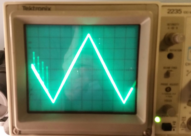

I have a low cost audio playback (speech only) project and wish to use PWM reconstruction. Currently I playback at 8KHz and I'm exploring the quality at various bit resolutions from 12 down to 8-bit
I do have it working but I'm suffering from some intermittent breakthrough noise spikes which kill the audio quality. At first I thought its just my breadboard circuitry that needs better grounding, shorter leads etc however I then decided to carry out a simple test which also highlighted the same problem.
Hardware
The primitive test h/w simply comprises of a RC filter with around 4KHz cut off frequency (and an ac coupling cap). I've made the leads as short as possible by soldering the components close to the relevant port connections. P1.9 PWM05; P3.2 for GND.
Software
The PWM frequency for the waveform shown was set at 64KHz. To catch the noise the easiest way I found was to generate an upward and downward ramps (sawtooth). To do this I use the clock module in TI-RTOS to generate calling a function at 8KHz. In the function I simply inc or dec a counter and use 'MatchSet' to alter the mark/space smoothly and so generate the sawtooth waveform. (The code has a lot of excess baggage but it would be possible to minimise it if really necessary.) What's interesting is that the noise often (but not always) appears as a group of 4 spikes and is always on the same slope. Increasing the PWM frequency to 250KHz and above reduces the noise significantly however of course I lose bit depth and can only do this for 8-bit.
Have you in TI tried to generate analog out from PWM and have you seen similar behaviour. Do you think the source would be RF coupling, power lines or other and would you have any suggestions to minimise this ?
Is there a way (h/w or s/w) to easily switch off the RF transmission to see if the noise disappears.
Thanks for your support. Any suggestions welcome.
regards,
Stuart
Edinburgh. UK.
  • Hi Stuart,
    A few suggestions for debugging:
    1. You can easily turn off the RF on the CC3200 by simply never calling sl_Start() in your code.
    2. Capture just the PWM waveform output and look for any glitches or unexpected behavior.
    3. This may or may not be affecting your setup, but I would suggest repeating your test with the CC3200 timers instead of TI-RTOS. There is a PWM example in the SDK that you can utilize. This will give a better idea if the issue is hardware or software based.
    Sarah
  • Hi Sarah,
    Many thanks for your prompt support. Feedback below.
    Ans: Understood. In my application my tasks (including the one calling sl_start() are set to priority -1 so are never running. I only run the 8KHz clock module 'task' so it seems it's not RF interference.
    2. Capture just the PWM waveform output and look for any glitches or unexpected behaviour.
    Ans: mmm ... difficult to see any problem looking at the mark/space digital waveform (that's why I generate the ramps). Also I don't have a digital scope or logic analyser available to me at this time :(
    Ans: OK, have taken the PWM example from the SDK and modified it to simulate my application. In short I just use one timer for the YELLOW LED and comment out the others. I then use 1250 as the reload value to simulate 64KHz PWM. The UtilsDelay in main() I shorten to get all running quicker so I can generate a ramp using the iLoop count value directly(changed to int). I'll attach the code. Unfortuantely I'm still seeing the spikes (see attached sdk_pwm_example.jpg) so it doesn't seem to be related to TI-RTOS.
    My thoughts
    1. Can you confirm that when 'MatchSet' is called it does not load the new PWM value instantly but rather waits for the next reload point. If it loads instantly this may cause glitches however this would be a very non standard way of handling PWM so I'm doubtful this is the case. (By the way I've also previously used the PWM api with same results).
    2. What is actually running in the background when an application like 'PWM' is loaded and running. Is there something that can cause a global type interrupt or even disable interrupts at some low frequency ?
    3. Possible for you to replicate this ? Code is attached and h/w is very simple.
    best regards,
    Stuart
    PS. Not sure if you can pick up my 'main.c', let me know if I need to copy and paste it in.

    When starting at max MARK and decreasing the MARK/SPACE ratio the downward ramp produced is ROCK SOLID.
    It's only when starting at min MARK and increasing the MARK/SPACE ratio for the upward ramp that I get the noise spikes.
    I'm not seeing any logical explanation for this other than the counter for some reason very occasionally not being loaded correctly.
    Have tried multiple Launchpads and different timers/pins.
    I've modified the code and I'm currently using PWM0 (pin21) with same result. The loop I use to generate the upward (noisy) ramp is below.
    while(1){
    UpdateDutyCycle(TIMERA1_BASE, TIMER_A, iLoopCnt);
    MAP_UtilsDelay(80);
    iLoopCnt = iLoopCnt+1;
    if (iLoopCnt == 1200) iLoopCnt = 50;
    Any further thoughts on your side (perhaps with my earlier questions) ?
