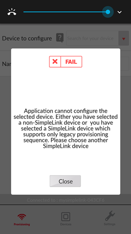

  • Hello Sarah,
    Thanks for your response! I tried following the thread you mentioned as closely as I could. That thread is talking about "provisioning_config" instead of "provisioning_ap". I have included the provisioning library define and rebuilt the SimpleLink library for NON-OS. I have also updated the service pack on my board. Unfortunately I am still getting the error seen in the attached photo. Do you know how to turn on debugging for the provisioning application in order to print out more information to the UART?

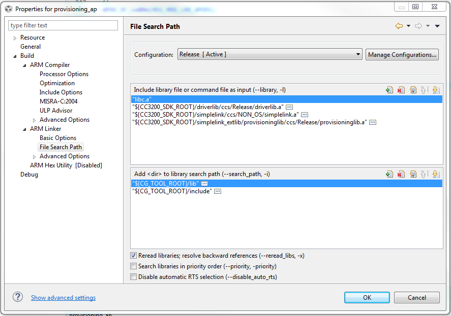

  • Hi All!
    Is the "provisioning_ap" project supposed to be a TI-RTOS enabled project? The table here: http://processors.wiki.ti.com/index.php/CC32xx_SDK_Sample_Applications#Network_Reference_Examples_for_the_CC3200_LaunchPad
    Lists the "provisioning_ap" example as a TI-RTOS project. What is the proper library configuration for this project? Here is what the library includes currently look like:
    Eric
  • Hi Eric,
    The Provisioning AP example should come with UART terminal printing enabled. Please check that the NOTERM is not a predefined symbol in your project properties. If you are still unable to print to the terminal (such as if uart_if.c is not included in the project files), please see the thread I posted above for how to add terminal printing to any CC3200 project.
    The screenshot you showed me says that you are trying to provision the device while connected to "altran-guest" network. You need to be connected to the CC3200 AP. This is by default "mysimplelink-000000" where the last six characters are your MAC address. You may have to wait a minute for the AP to be visible when you run the example. Please see detailed instructions here: http://processors.wiki.ti.com/index.php/CC32xx_Provisioning_AP
    The table shows you that the Provisioning AP example was updated in a previous SDK. The deprecated version used TI-RTOS, but the current version is Non-OS.
    Sarah
